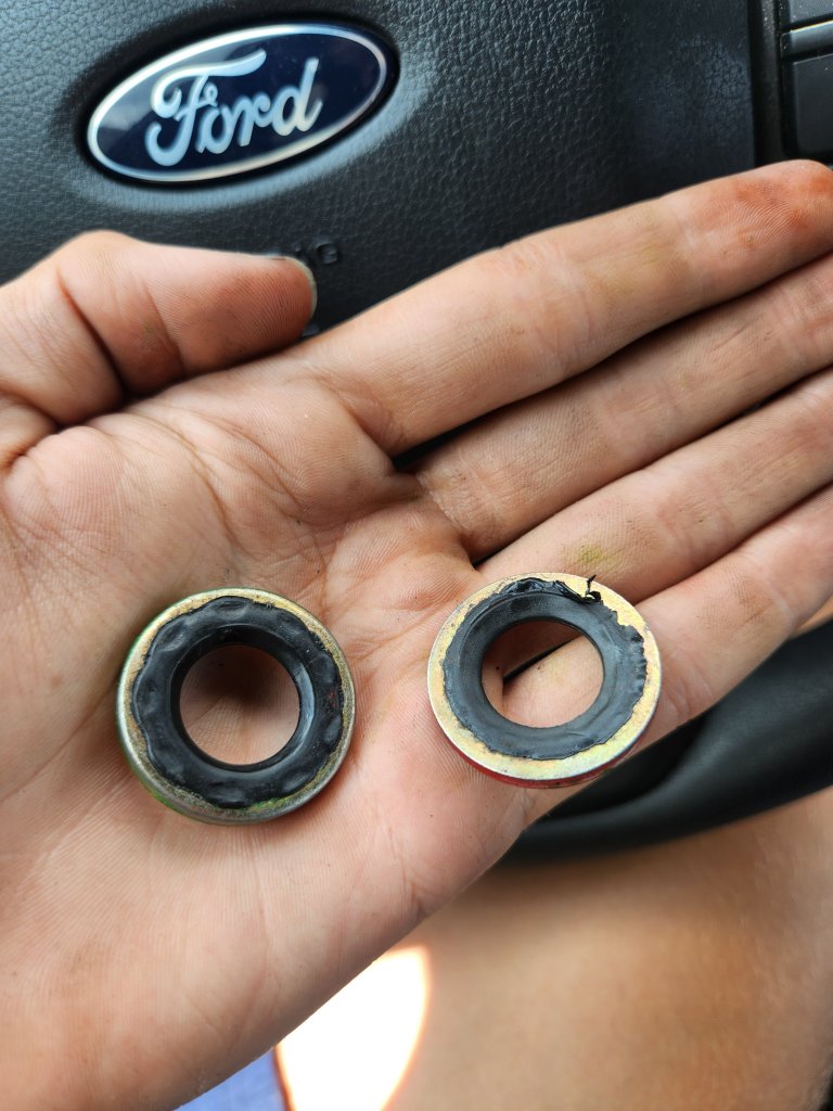

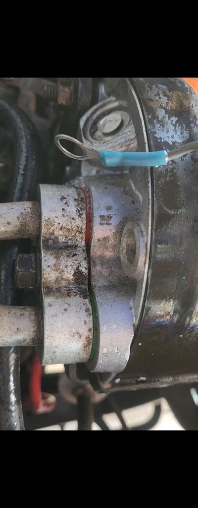

The one and only leak.

Little ahead of ya.
Alrety charged the system. Blows cold i just need some more insulation and to seal off the cab

You find the leak with pressure,or vacuum?
