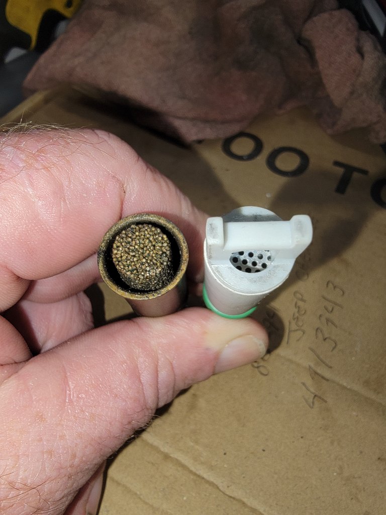

69 should be the big brass stone instead of the plastic tube. 78 or 79 is about the time they started using the plastic orifice tubes. 134 is the reason for the change in design. It needs the smaller valving. Although the the brass is reusable and doesn't break down from heat, it's harder to tell if it's clogged. Heat is why you should replace the plastic tube every time you open the system. Left is original 73. Right is retro for 134

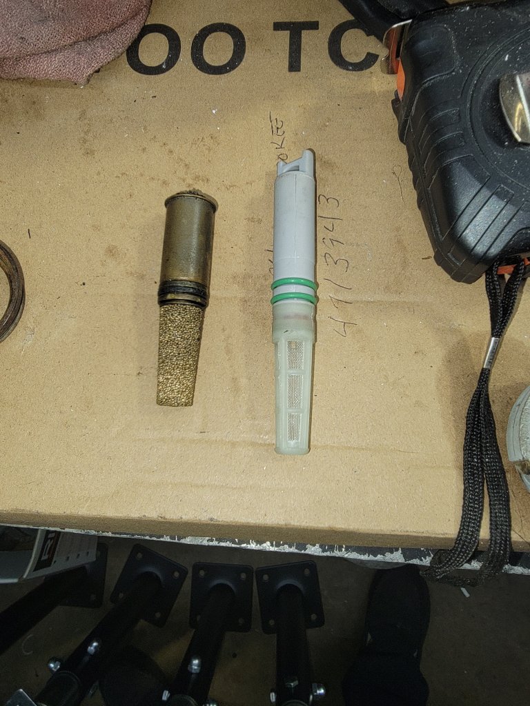

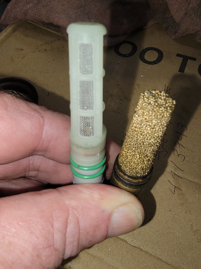

Couple different views
