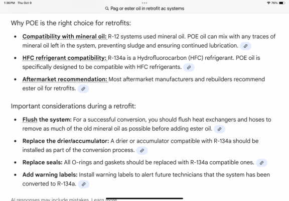

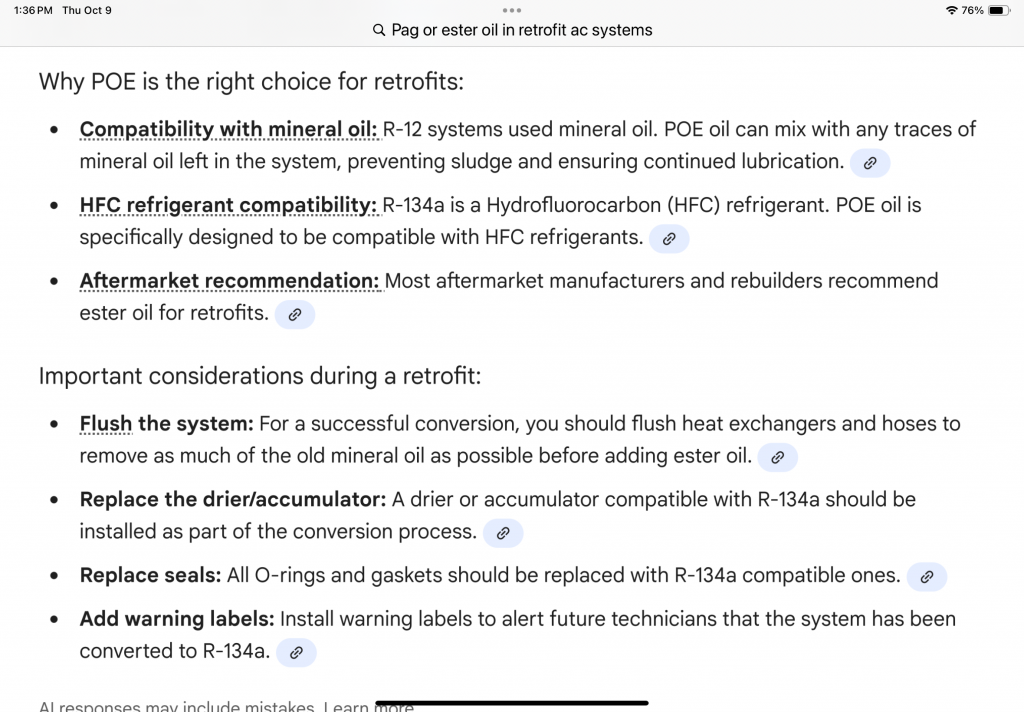

Don’t know of any shop, but the oil should have been replaced with Ester oil. PAG is a corrosive and will take out O-rings as well as evaporators in older R-12 systems. I believe it is the shop’s bad IMHO
