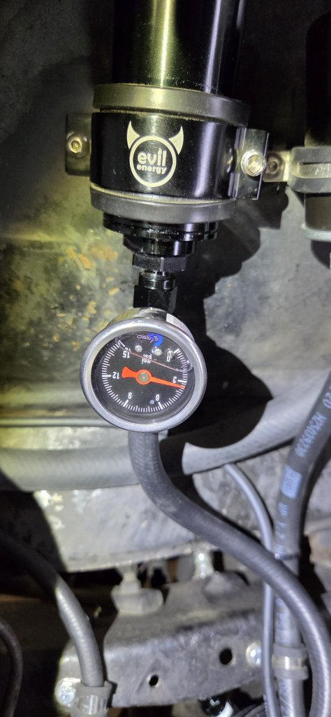

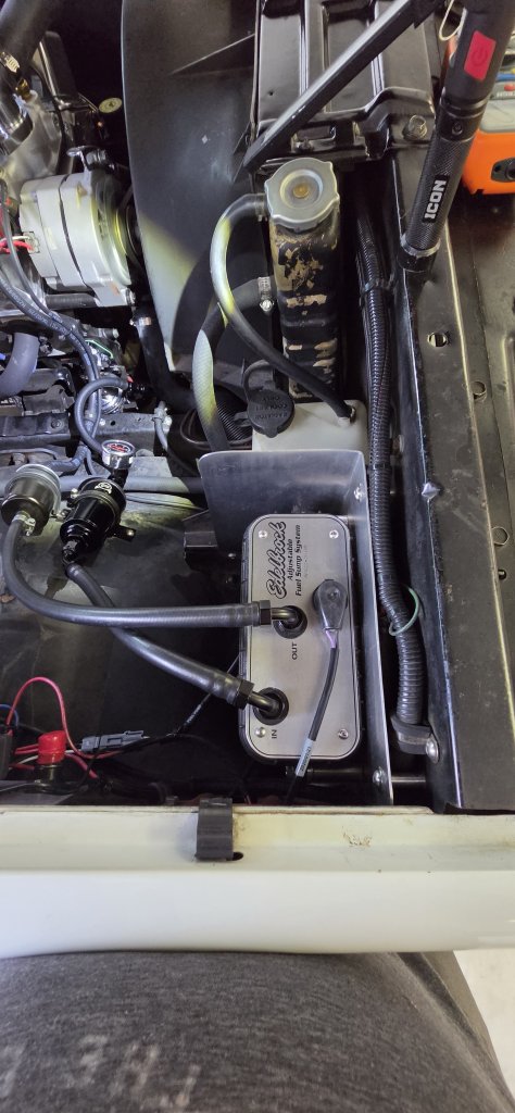

I'm sure this has been discussed several times in the past, however this one might be a little different. 1978 C10 Big Ten, so no evap system. Dual tanks, OEM. I built a 377 for it 2 years ago and fitted it with Edelbrock ProFlow 4 EFI system. I used the Edelbrock fuel sump kit so I could retain the factory dual tank switches and system. So the fuel delivery is all original style from the tanks to the mechanical fuel pump on the engine. No return and the tanks vent right off of the sending units. This year for the first time the engine died while driving on a day the ambient temp was 90+ degrees. I have a fuel pressure gage attached at the input of the low pressure side feed to the sump, between the mechanical pump and the sump inlet. It read 0 psi. I let it cool down about 20 minutes with the hood open and it restarted and pressure came up to 3 psi, normal was 5.5 psi. I figured it was a dead mechanical pump, one of the only 2 parts that came from the original engine. I bought a 110 GPH pump from Summit and changed it. When cold it runs 6.5 psi but after about 30 mins running it dropped to 3 psi. I bypassed the tank switch and went straight to the LH tank, no change. I filled the tank with clear premium, no ethanol (ouch) and no change. Cold pressure is fine, when running for longer than 45 mins with temps above 90 degrees it will drop to 0 psi, same as the old pump. This sure sounds like vapor lock, but over the last 2 years even in high heat it never did this. Is anyone experiencing similar issues? Could this be a RVP issue from winter blend fuel? I live in the Pacific NW and we are now getting California blends due to their loss of refineries and they are now getting gas from the Washington refineries and we are told they are now running the CA blends for everyone up here as well. I've attached a couple of photos of the configuration. Any ideas would be greatly appreciated!
