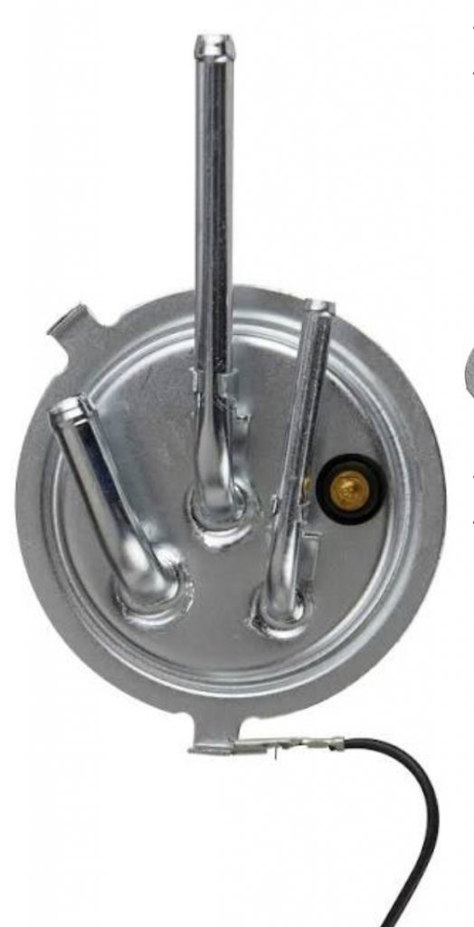

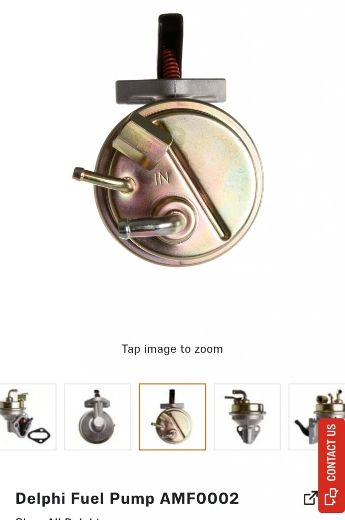

Greetings Square body gods!! My dad picked up a 74 Sierra 2500 4x4 when I was about 17, I'm now 54. Over the years it was always reliable. Until.... it runs out of fuel with full tanks!
I live in Arizona. Heat is the issue for corn fuel
I've replaced both sending Units, tank selector solenoid, all existing fuel line and gone through several mechanical and electric pumps, rerouted the lines away from heat and still starves for fuel, especially during the summer. During the "winter" not so bad. A buddy gave me a 3 nipple fuel filter to return vapor and boiled fuel but my sending units only have 2
Has anyone else experienced this?
Winter restarting isn't an issue, acceleration is.... fuel isn't making it to the carb before boiling. Will the 3 nipple filter help? Can I use it?

The solution would have been to put a three connection pump and a three outlet sending unit in the tanks when you changed all those parts. Having the excess fuel return to the tank permanently solves the problem unless you are dumping a ton of heat in to the line from the exhaust.

That'll fix it? Nuff said. Can't thank you enough. These 2 parts are under $100

If it starves for fuel in the winter,I don't think vapor is your problem. When's the last time you checked float level and trash in the float bowl. I do agree that a 3 port pump and a return line is a vastly superior system. Here's something to consider. Did you put an electric pump back by the tank in your electric pump installs. I'm asking because boiling points change based on pressure. Liquid under vacuum boils at a lower temp,liquid under pressure boils a higher temp. If you installed an electric pump at the front of the truck that can contribute to vapor lock by creating a vacuum. Back by the tank it should eliminate vapor lock becausebit puts pressure on the fuel increasing boiling point.Keep the run to the tank short and the pump below fuel level. Is your tank vented correctly that can contribute to fuel starvation and vapor lock.
