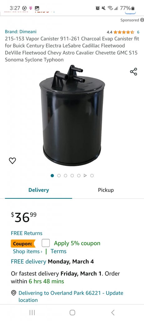

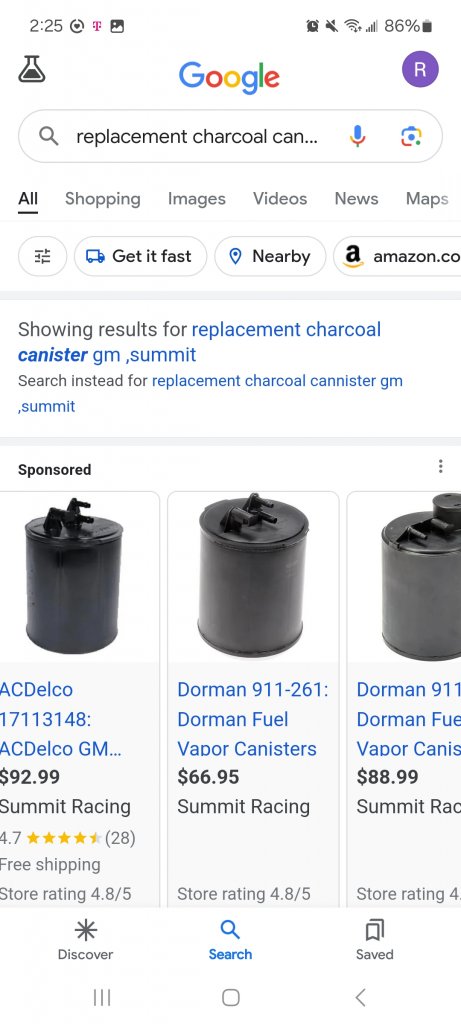

The cannister has definite value in keeping your fuel from evaporating, getting moisture in your tank ,rusting the tank,rusting the fuel lines,freezing I'm winter,but it's your truck. I've used a fuel filter plugged into a vent line to allow it to vent and still keep dirt and insects out.. I scoured for less than a minute

I found plenty of canisters online too, but they are either out of stock, discontinued or don’t fit my truck when I input the vehicle information.
It doesn't have to be an exact replacement,just like your fuel,filter,roll over valve,open hose,etc isn't an exact replacement.

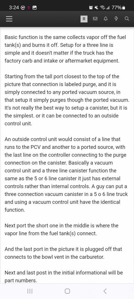

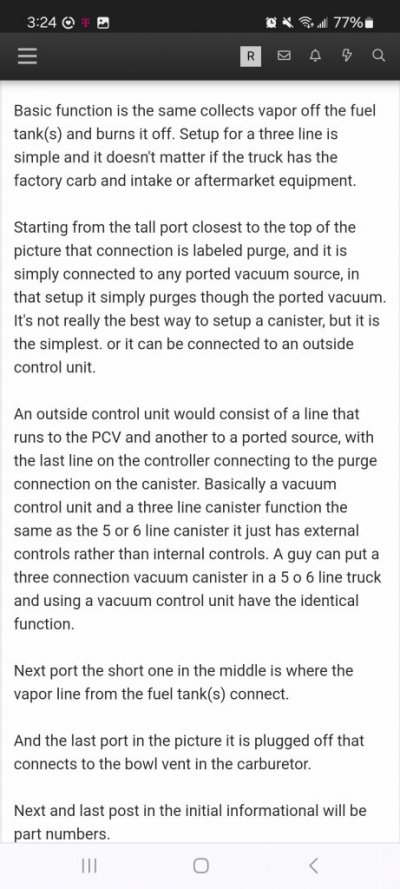

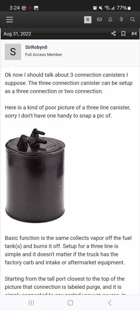

Blow up these pics.
