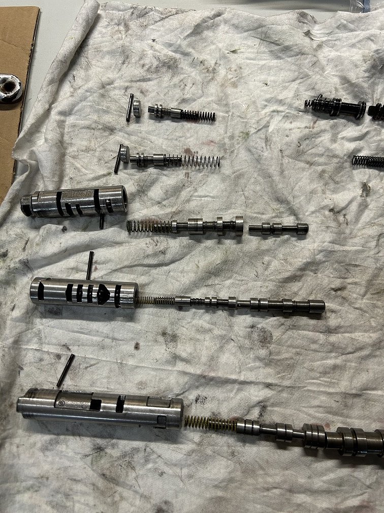

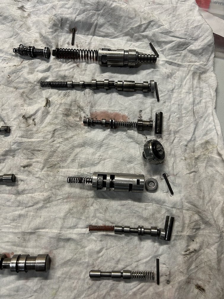

Busy week, but got back into it.
Finished the pump. Pump clearance was .0011 on slide and rotor. It did have a .500 boost valve, but I replaced it with a Sonnax o-ringed .500 boost valve and reverse boost valve. Also installed Sonnax TCC valve with teflon sealing ring. Failed to take pictures.
Did a dry assembly and checked end play. End play was .030, so I added a .015 shim to get it a bit tighter. If I had a thicker washer, I would have liked to tighten it up a few thou more, but I don't, and I need to wrap this up.
Tore it all back down and soaked frictions, gear sets, and band in ATF. It's going to sit a while while I build an engine.
Reassembled everything and moved on to the valve body.
Some transgo stuff. The TV valve is definitely transgo. Going to send it.
Cleaned it all up and reassembled.
