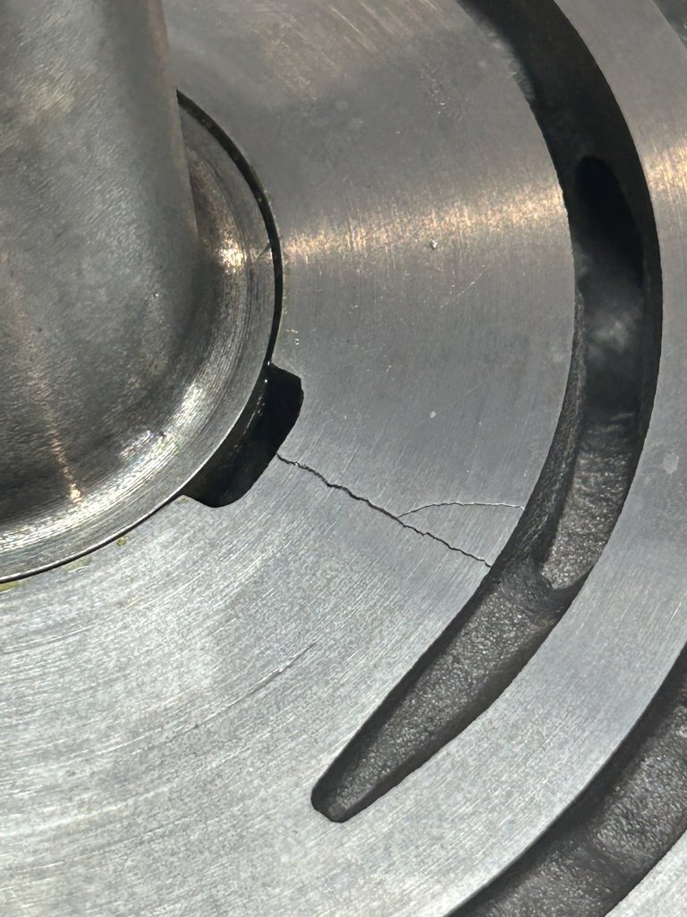

Resurfaced pump, pressed out stator support, and checked pump clearance. Pump rotor and slide came in at .0018 after machining the pump.
Waiting for new Sonnax stator support to show up.

F@cking f@ck
That sucks, man - sorry to see...i had a similar situation a month ago - found out the stator support was warped. Had to cannibalize another 700R4 core to put that pump back together.
