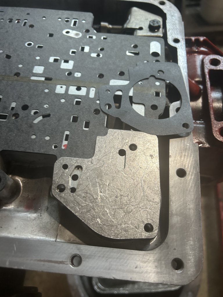

Blocked 4th accumulator feed by tapping and plugging the feed hole.
Blocked the line bias valve with a piece of aluminum rod
Plate now

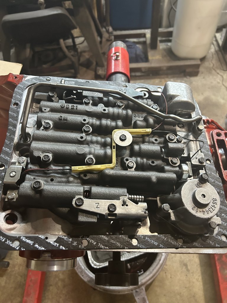

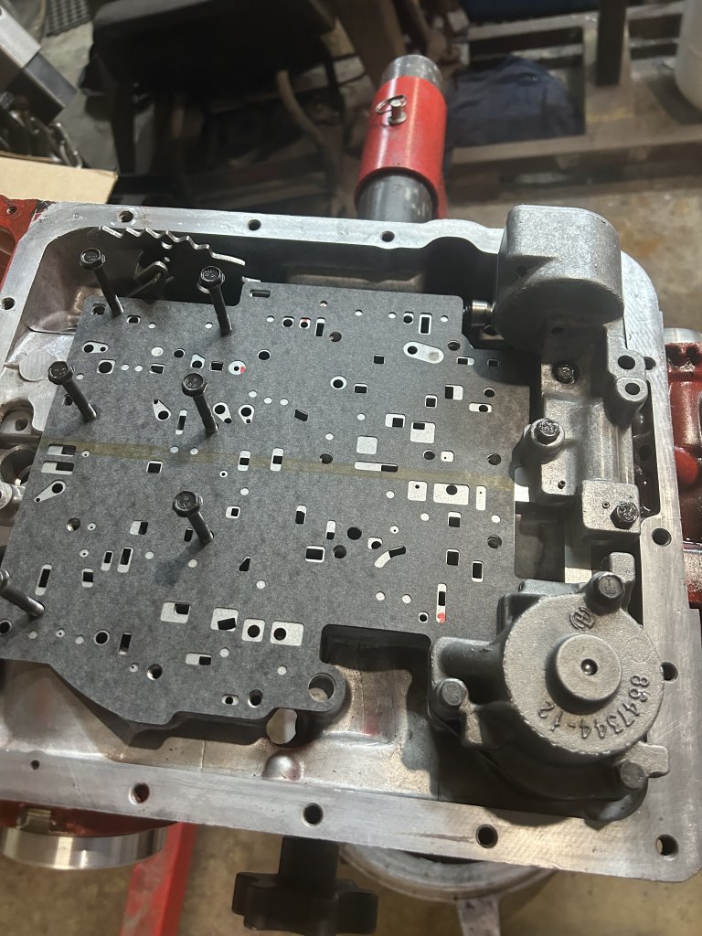

Time to finish up

Top notch for sure.
Looking forward to seeing your truck in running/driving condition

That looks great, excellent job and presentation of the build progression!
Can't wait to hear the test drive report!
