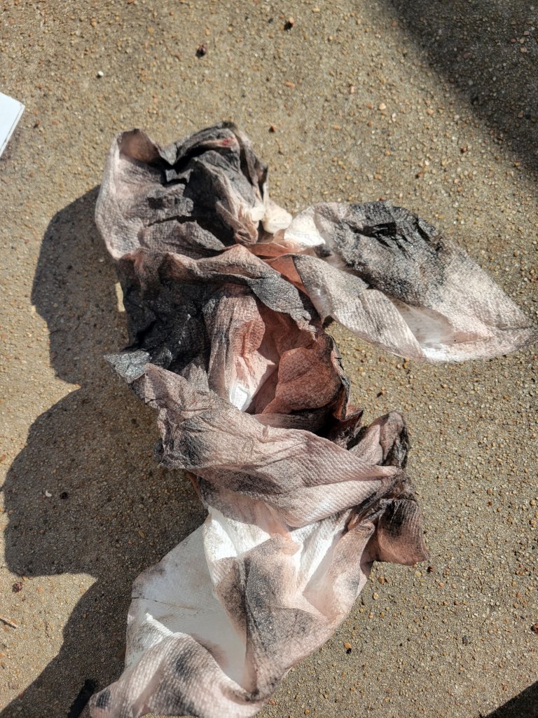

dropped the pan and put in a new filter. there was definitely clutch material in the pan, but not sure if it is crazy abnormal. it has been about 50k miles since the pan was last dropped for a filter. no other abnormalities or parts in the pan. attached is the paper towel I wiped the pan with for a little bit of a reference. between what settled out in the pan after a while and what fluid dumped out of the filter, there was more clutch material than what is shown on that paper towels for sure.
brief test drive afterward and everything is still shifting fine.
any other thoughts on the delayed OD/D engagement when shifting from a cold start in cold temps?
