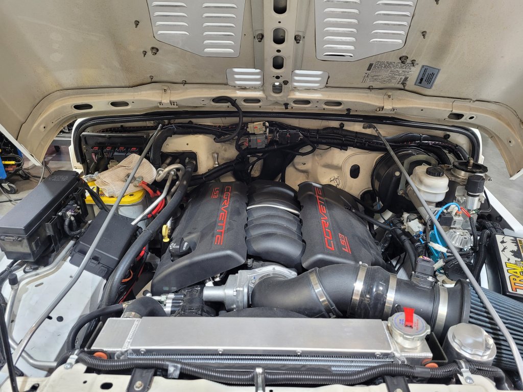

I am learning that these wiring systems are only as good as the person installing them. I have been working on a rock crawler jeep for a client that had the Painless wiring system installed by someone that obviously does not do wiring on a regular basis. Who ever installed it bundled up the wiring that comes attached to the fuse/relay block under the hood, on top of the fender. Looks like crap, original installer lacked the basic planning to shorten the wires before connecting the system. I have gone over original install and cleaned up crappy wiring job, did the best I could without starting from scratch.
Now I am starting over and removing the Painless block and wiring, replacing it with something different and smaller. Pulling out all the added wire looms to reduce the amount of wires crossing the engine compartment before rerouting them. I was able to reduce the amount of unnecessary bulk by removing the lose jacket on the pairs of wires and grounding locally instead of running the ground wires all the way across the firewall to the ground location the first installer choose without considering the big picture.
Picture below is what it looked like after the first clean up session. The client is making the choices on what type of wiring system to use, I just install what ever the client asks me to. Hope this info is helpful in making an informed decision on what system to use. After playing with the Painless system the only critique I have is the fuse/relay box is huge compared to others.
The Painless system is quality, and planned properly will work very well. High quality wire, connectors and hardware compared to other automotive wiring
