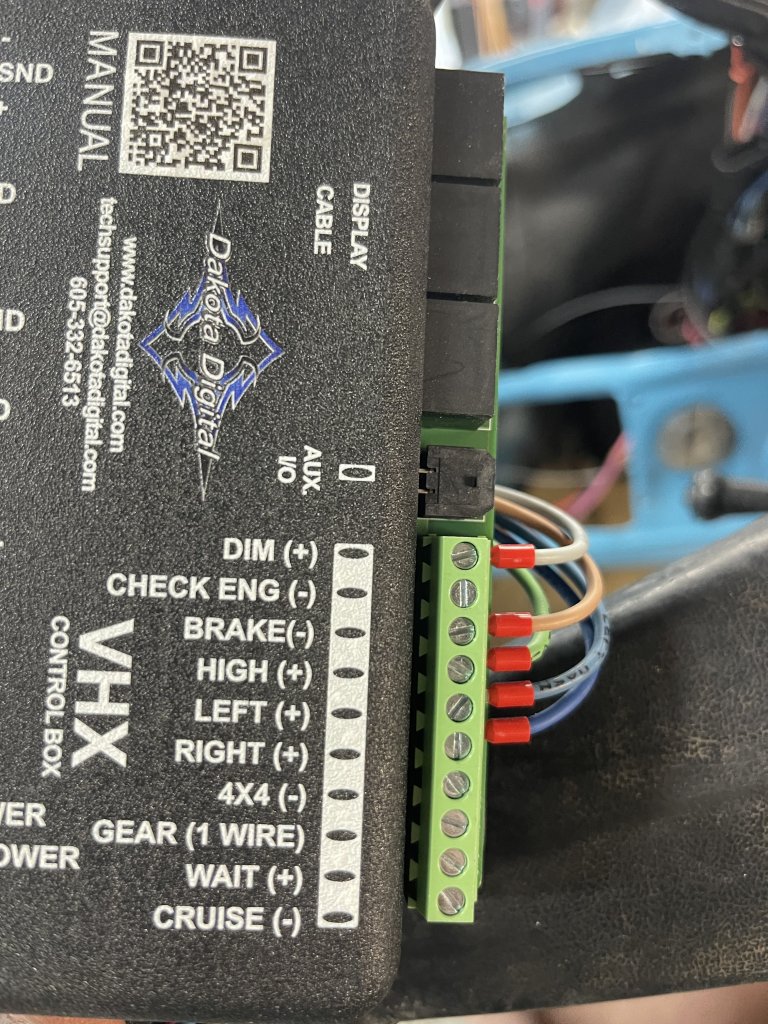

TCI- TCU connections to the DD setup.
Speed outlut from TCI (orange) wire to the speed send terminal.
Pink wire- 12v ignition- there is an extra 12v key power on an unused section of the tach connector. Put a terminal on the wire and installed in spare 12v ig power.
DD wiring devices-
Oil pressure is a 3 wire and shield cable. It has you term shield and black under same terminal. Best way to do this is put them both in Ferrell then crimp. The other wires are color coded. Oil pressure sender is in factory location.
Thermostat- 2 wire unit and terminals are labeled. Mine is on the front top of the intake. The factory sender location here will not work with this sender and you will melt it if you have headers.
Make your cable long enough to bring the terminal box out to work on it. You will thank me later for that. Nothing like trying to mess with terminals somewhere you can barely reach.

What connector ends are you using there?
They are called ferrules. I use them in my day to day in control panels. It gives you a solid connection for the screws vs just tightening down on the wire which you can jiggle and pull out. This isn’t the exact ones I use but an Amazon prime kit that has a good start.
Thank you. What gauge wiring are you using?
I think we’re running anything between #10 in there someone to I think I saw a 20ga wire coming off something.

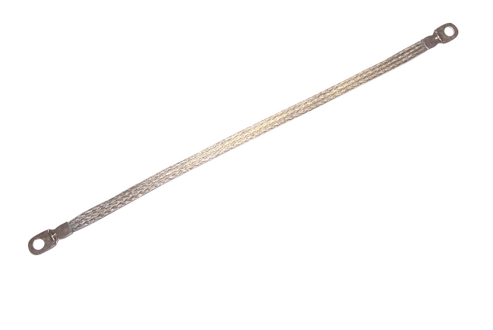

Progress today- a little electrical, a little mechanical, and some body to frame grounding.
Working on the electrical under the hood. Just getting stuff where it goes etc. Ran the power cable from the alternator to the battery mega fuse setup. It shows it a bit different on the diagram with the kit but we are going this road- Altenator to battery fuse and another one off the battery to the starter. Also ran the main fuse block power wire here which is show to make a junction at the starter.
No pics of it but installed grounding straps from the frame to each body section- Bed/Cab/front clip. Grounding is always a problem with these units to hopefully I have curtailed that issue out of the gate.
I use these. Drill/tap the frame- clean the paint off, throw the bolt in, put a locknut on the backside/ paint over it to protect the exposed metal. A small dab of dialectic grease between the strap and frame.
