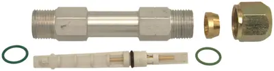

Back in the day NAPA used to make a repair kit. You cut about 4” out of the old line and installed the repair kit. It was made out of steel and came with everything you needed. I have installed several with NO PROBLEMS. Might try 4 Seasons or Temp, I would try the TECH HOTLINE and hope you get an OLD TECH. GOOD LUCK
Seems like drastic measures for just a commonly "stuck" orifice tube.

Napa #201060
Looks good Butch, $25.99
