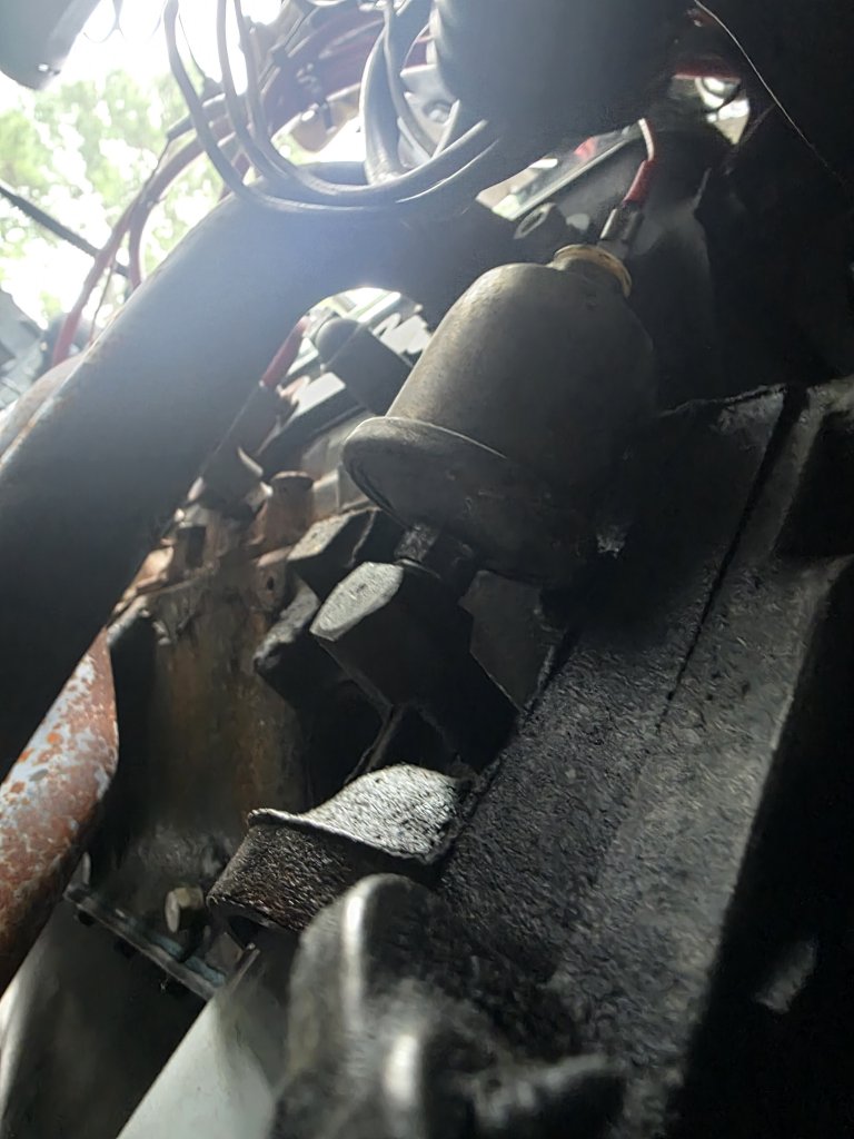

Sorry for the delay, I'll get a few pics up today to show where it is. It's just a 1 wire sender that runs to the guage. It's bad because I checked everything else out first to make sure it wasn't the wire or gauge. Thanks for the advice from you and the others. My apologies again for the late reply.
Why not just use an alternative location to mount the same thing
If its a 1987 with the tbi, the switch part of that assembly is designed to provide an alternative ground to the fuel pump relay im pretty sure, which even chevy deleted in the 1990s probably realizing they had reliable enough computer grounding
Then the gauge on the dash can be run off the port by the distributor. leave the original alone if it wont budge. is the one by the oil filter using an adapter that comes out of the block that the switch/sensor screw into ?
it looks something like this , right? show us what you meant if you still need to use this location
This is an example of where the location im telling you to use is, its by the distributor toward the firewall on the little landing the distributor opening is at. that supports my gauge sender , and it can probably support the switch for the fuel pump too but it would probably take a second or so more cranking to get it to do its thing just because its higher in the oil feed circuit i presume

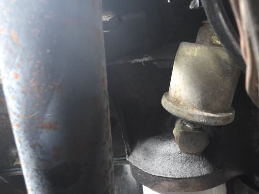

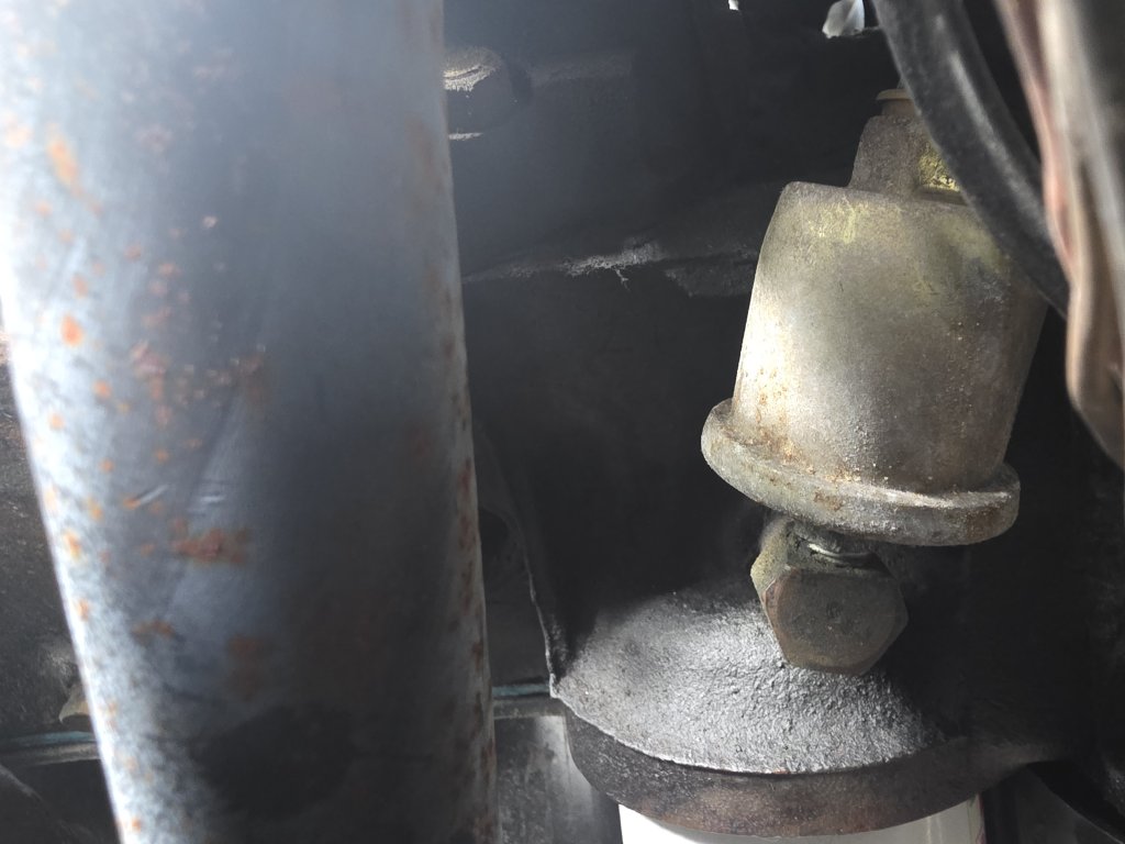

These pics are from up top and underneath the truck, but that's where my pressure sender is located, on a brass fitting.

Nobody asked the OP why he was removing it. Maybe he just wanted the challenge? Mountain climbers understand.
I am trying to remove it because it no longer works, so I'm driving without knowing what my oil pressure is at.

If there is clearance to do so, just remove the fitting and sender together, clamp the fitting in a vise to support it and remove sender.
Or put vise grips on the fitting to support it and remove sender in the truck.
Or break the fitting off, remove remainder of brass fitting from block and replace both sender and fitting.
I never thought of that, I was under the impression if I took out thay brass fitting oil would come spilling out. If it does, I'll put a catch pan down and fill back up. Thanks for the advice.

There might be a little bit come out, but when the engine is off all but a tiny amount of oil is collected down in the pan (and about a quart or so stilll in the filter) so worst case is you'll get a few drips or a dribble.

The problem often stems from the tapered thread seized by time, heat, and oxidation. To remove it without disassembling the engine, you can first apply a penetrating lubricant like PB Blaster and let it sit for several hours. Then, gently heat the brass fitting with a small blowtorch to expand the metal, while holding the fitting in place with a second wrench to prevent it from breaking.
