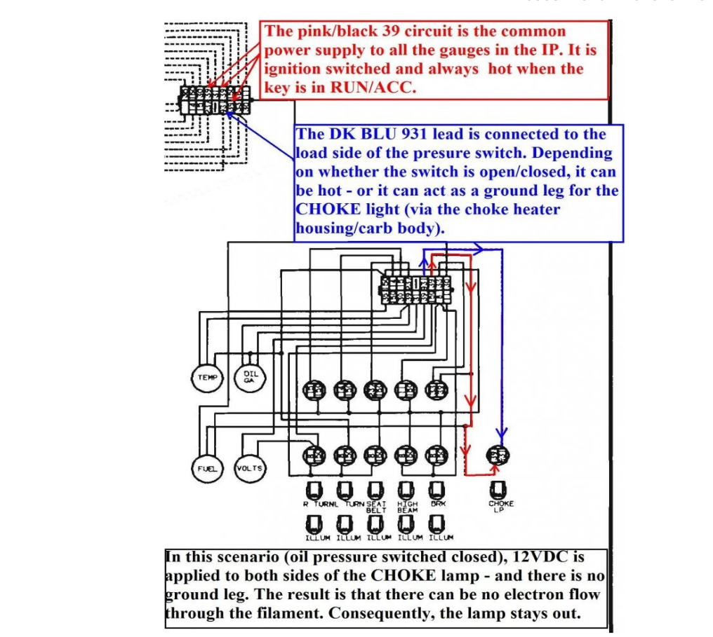

See attachment-

If I feed the unpinned dark blue wire power, the green wire at the plug gets power and so does the choke

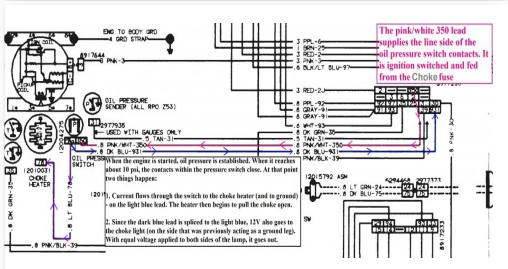

Here is some more info- see attachment

There's a grommet beside the bulkhead connector. The white wire goes from a three wire plug in the dash, through the grommet, into the wire harness. The white wire gets power, key on engine off.
The pink/black wire does not get power
I do not see a pink/white wire on the motor side

Not exactly pink but it goes from the bulkhead connector to the plug, with white tracer.
