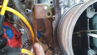

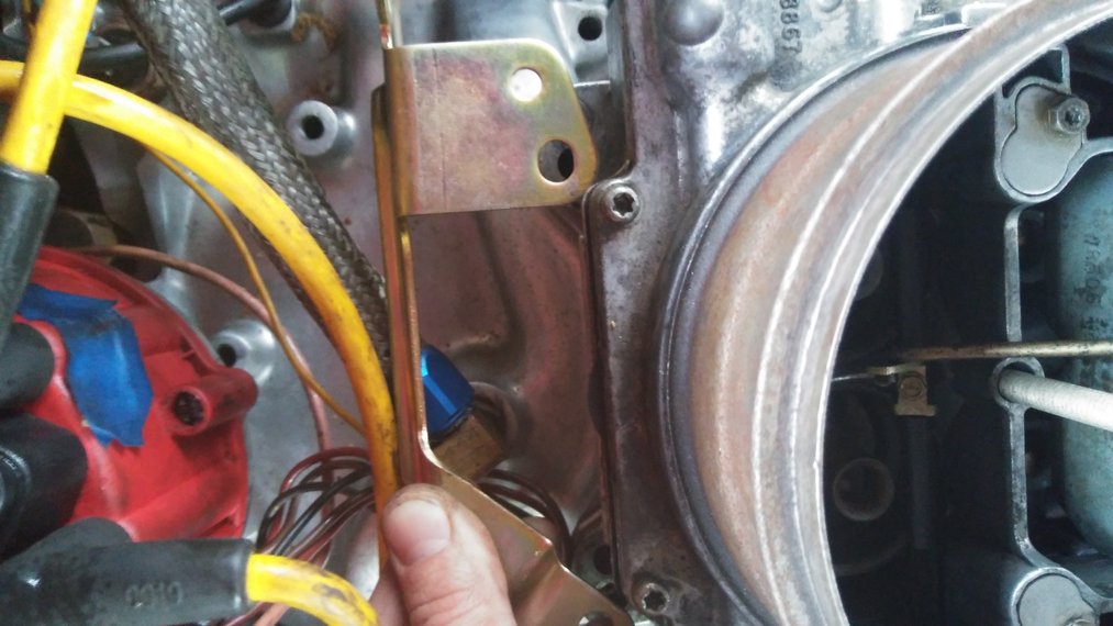

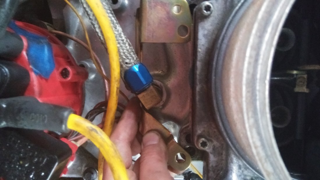

New snag. The new bracket mounts on the back of the carb but my brake booster attachment is in the way.

74 Shortbed
Aug 12, 2013
6,306
1,413
Yep, weld a strap across the top then cut the side out.

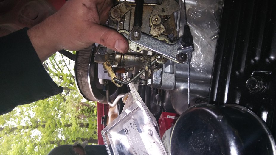

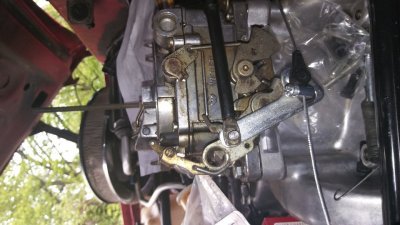

I installed a carb spacer and that gave me the clearance i needed. I put the geometry bracket on but im not sure the angles are right. Im adding 2 pictures. 1 at no throttle and the other WOT.

Did you get the cable installed in the transmission? I don't think those are threads. It's more of what I'd consider knurling. Sorta helps fix wallered out holes and helps keep the leaks down. It's not a bad thing if you needed it, but it can be a PITA. Just lube it up good and make it work. It's probably tighter than a 12yo, but that's a good thing. Work with it. It'll go.
47,210
9,483
That adjustmet and the exta long cable is what makes that the universal cable.
