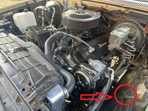

Are you sure its not that rusty bolt causing the problem?
