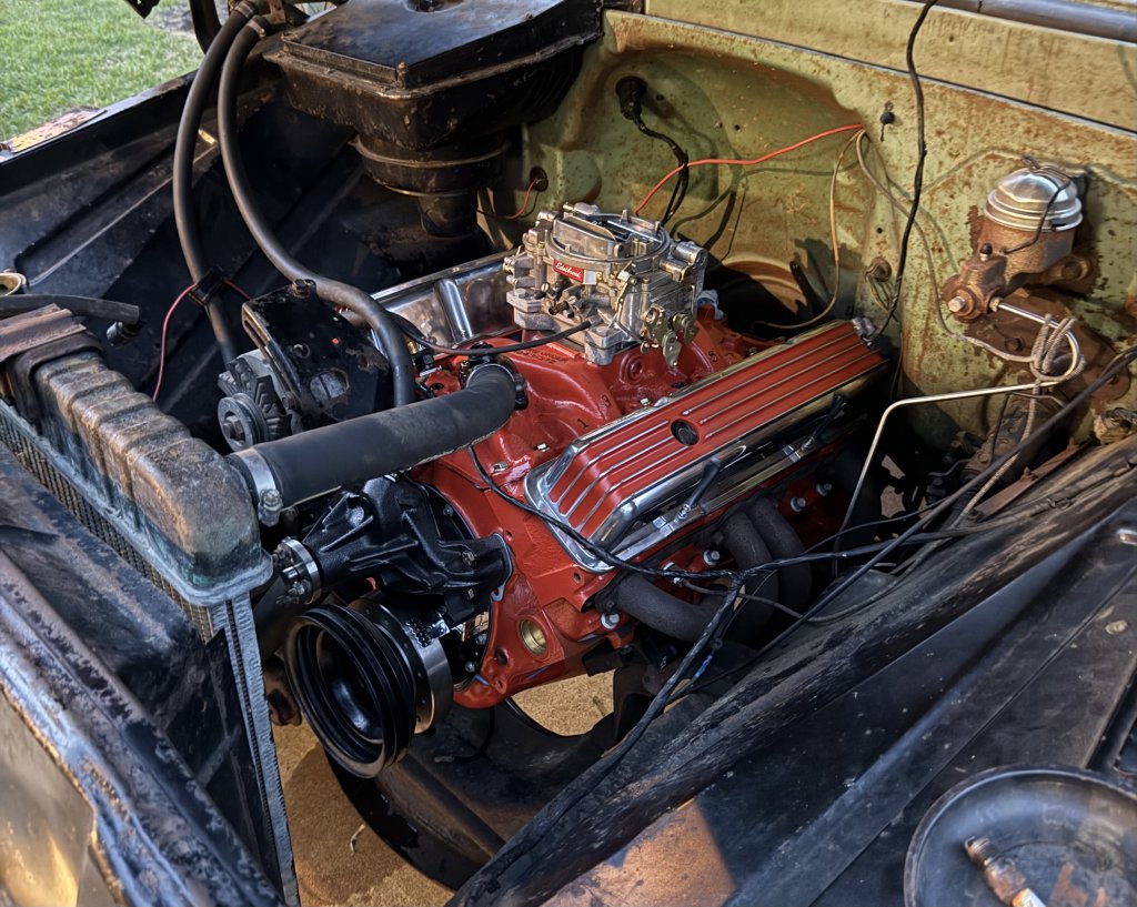

Got the starter in and hooked up. Got both headers in and hooked up, collectors not hooked up yet. Hooked up the oil pressure sending unit thing.
I still need to order a distributor, plugs, wires, fluids when I can afford it. This economy seems to be killing construction here.

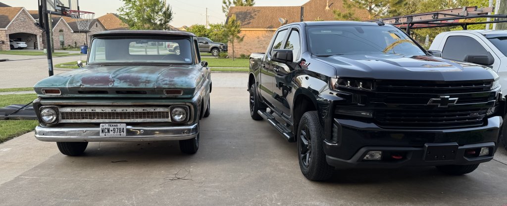

Obligatory picture next to my wife’s stock height trail boss, always amazes me how much bigger trucks have gotten.

Needlessly larger, esp taller
Needs to be bloated for all the extra wiring, air bags, tracking devices, etc
