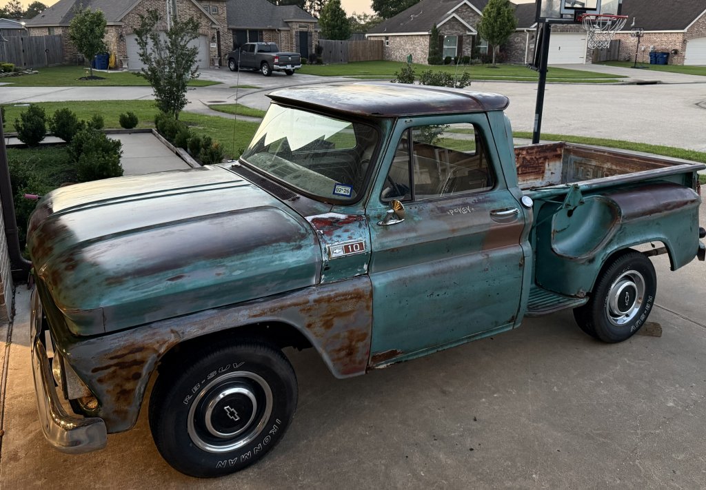

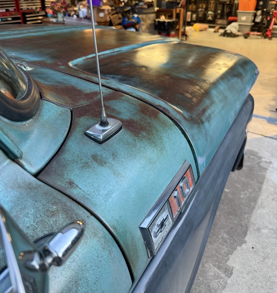

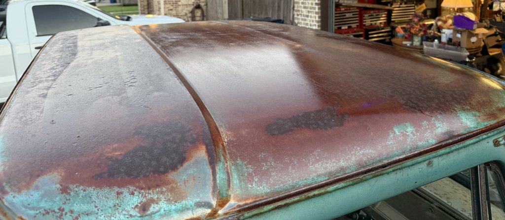

Got the poppy’s patina gloss clear coat wiped on and I think it’s gonna look good when it dries. Def will stop it from rusting.
Have done nothing mechanical to it but gonna buy some spark plugs tomorrow at least lol

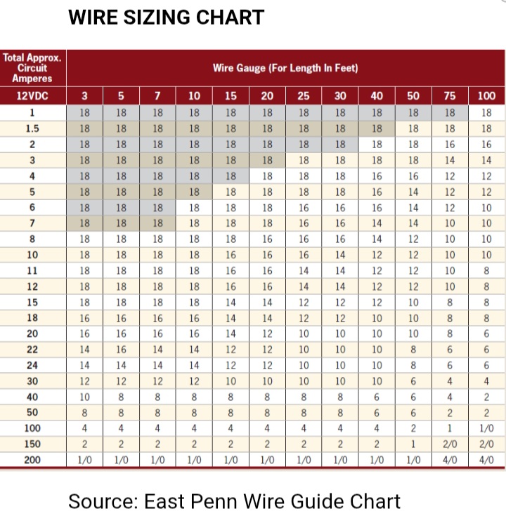

It will depend on a couple of things,it's not truly a 1 size fits all deal. The length of the wires affects the gauge needed. The maximum amperage draw affects the gauge needed. I'll put a thumbnail to a gauge to length chart,so everyone can evaluate there own situation. Keep your runs as short as is practical. I'd say 2 gauge,battery to engine,2 gauge engine to frame and 8 gauge battery to body. That's assuming battery to body is around a foot. For most people this is more than adequate.
Yes, It has 8 gauge from the battery to the core support, and 2 gauge from battery to engine. I just need to go to frame.
