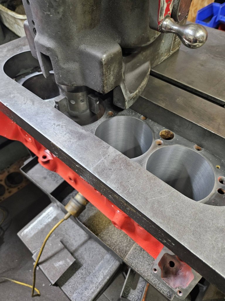

Hot rod it’s getting the 350 out of my old 85C 20. And then the 84K 10. It’s currently at the machine shop getting punched out 30. I did a valve job Seals and springs on the Vortec heads last week. I’m kind of dead in the water until the machine shop calls me.

Block work done

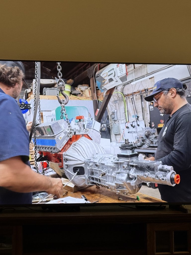

I just watched an episode of stay tuned, which is Tony Angelo guest starring Derek Bieri from vice grip garage, where they put a hot 327 with a TKX Tremec like I want in an old clunker. One thing I was worried about they solved for me. You have to use a dial indicator to make sure the bell housing is centered and if not, you use offset dowels. This whole time I’m thinking how the hell am I going to do that laying under this truck without a lift. Hell, they did it sitting on the workbench. Bolted the bell housing to the fully assembled engine, and did it all, bolt of the transmission to it, and dropped it all in as one piece. Duh.
I figured I should not build the engine until I’m ready to put it in the truck and run it.
