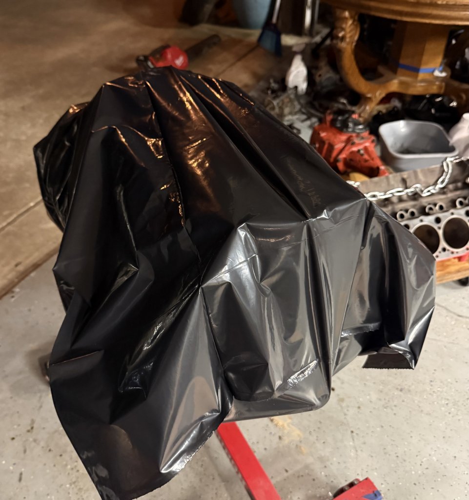

All the lifters look like they just came out of the box, and they practically did it wasn’t that long ago. None of them were stuck, no piston to valve contact, Everything looks normal to the naked eye, but I have to get those two valves out.
I was going to tear down the whole block with my nephew and give him a full crash course, but there’s nothing wrong with the rotating assembly. I’m just going to leave it a short block. I can show him how things work on the other 350 that is a part.

That’s where she’ll stay in the corner. That thumper cam and lifters are easily reusable, but that’s 283 needs a stock cam. Bout to work on the valves to see if they’re bent
