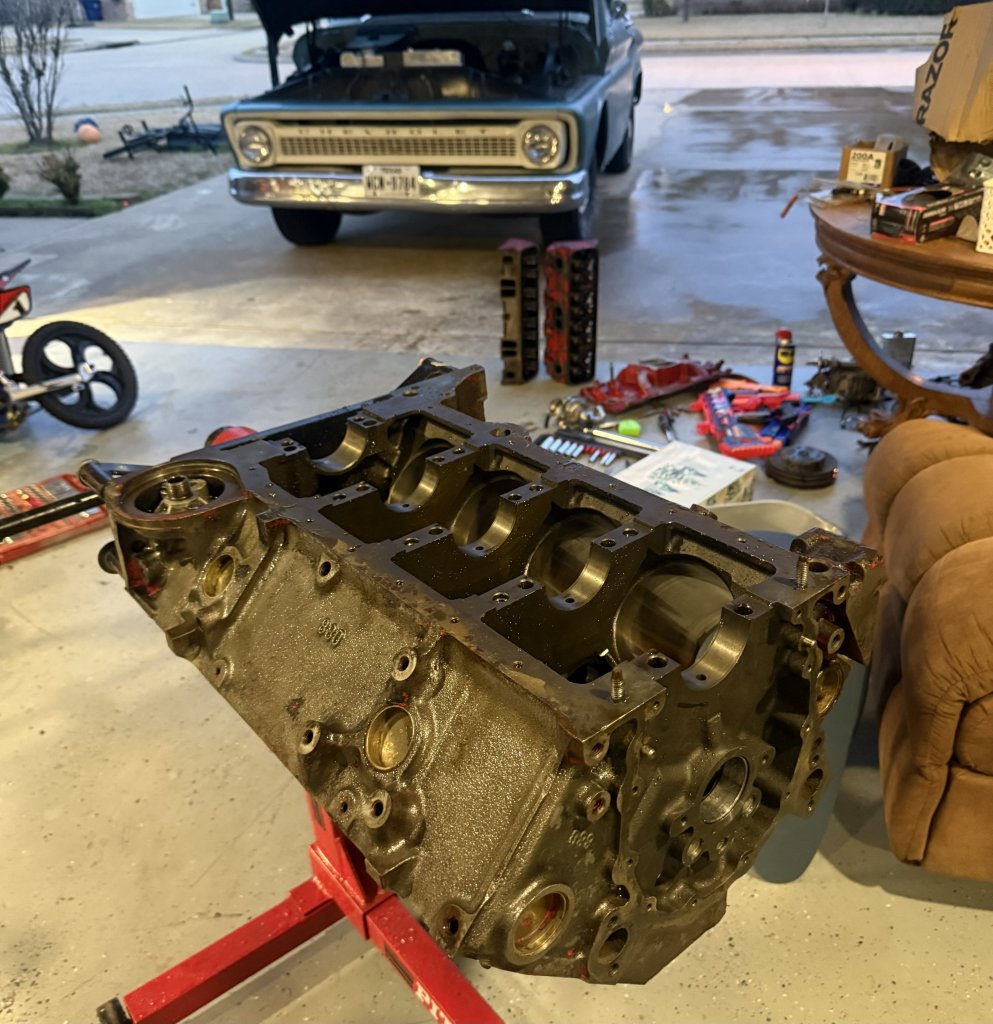

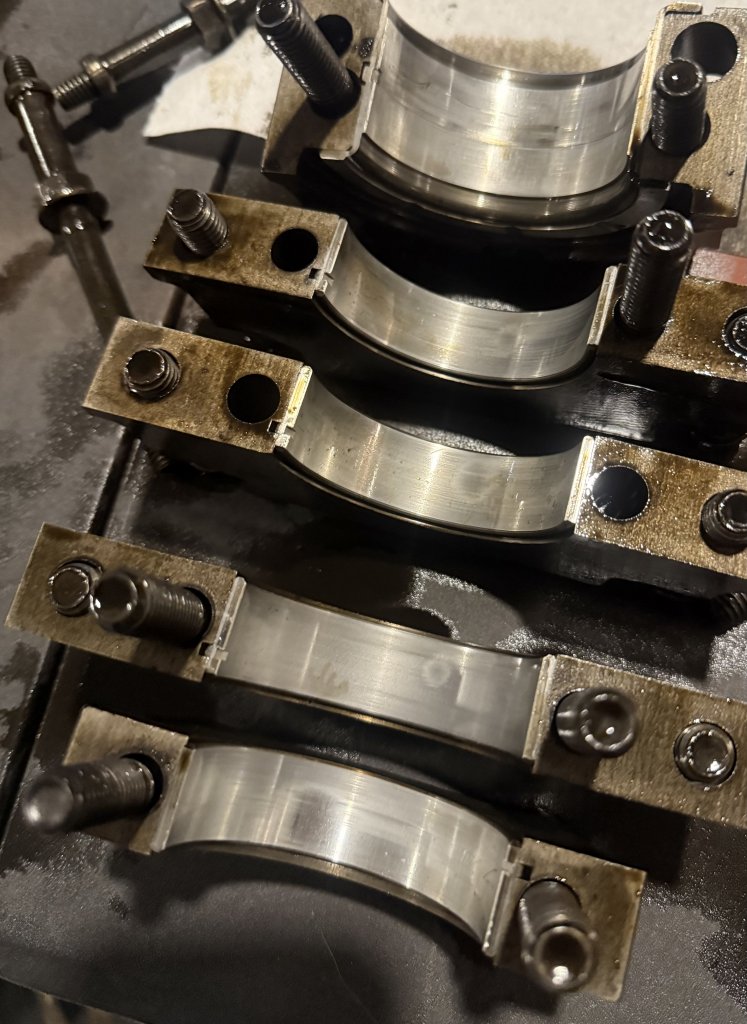

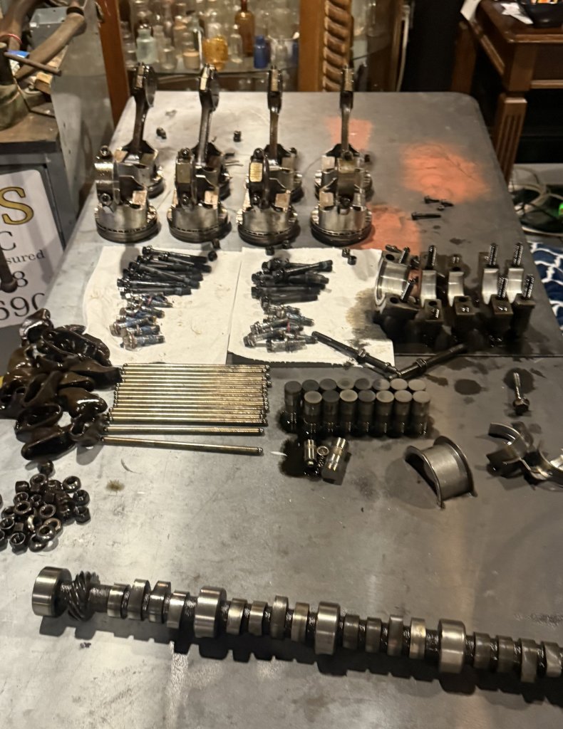

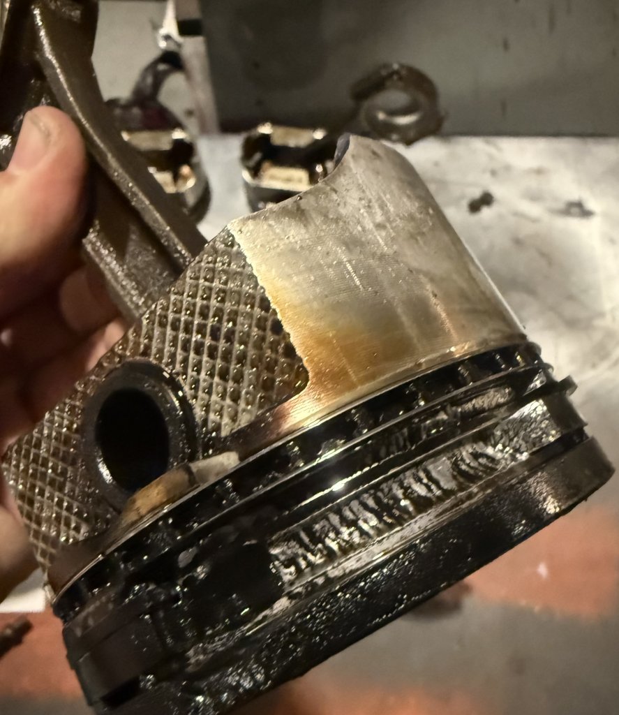

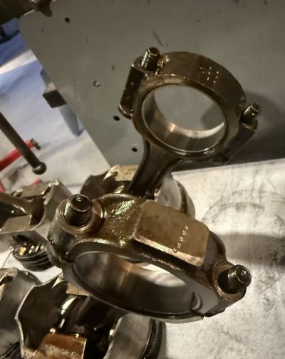

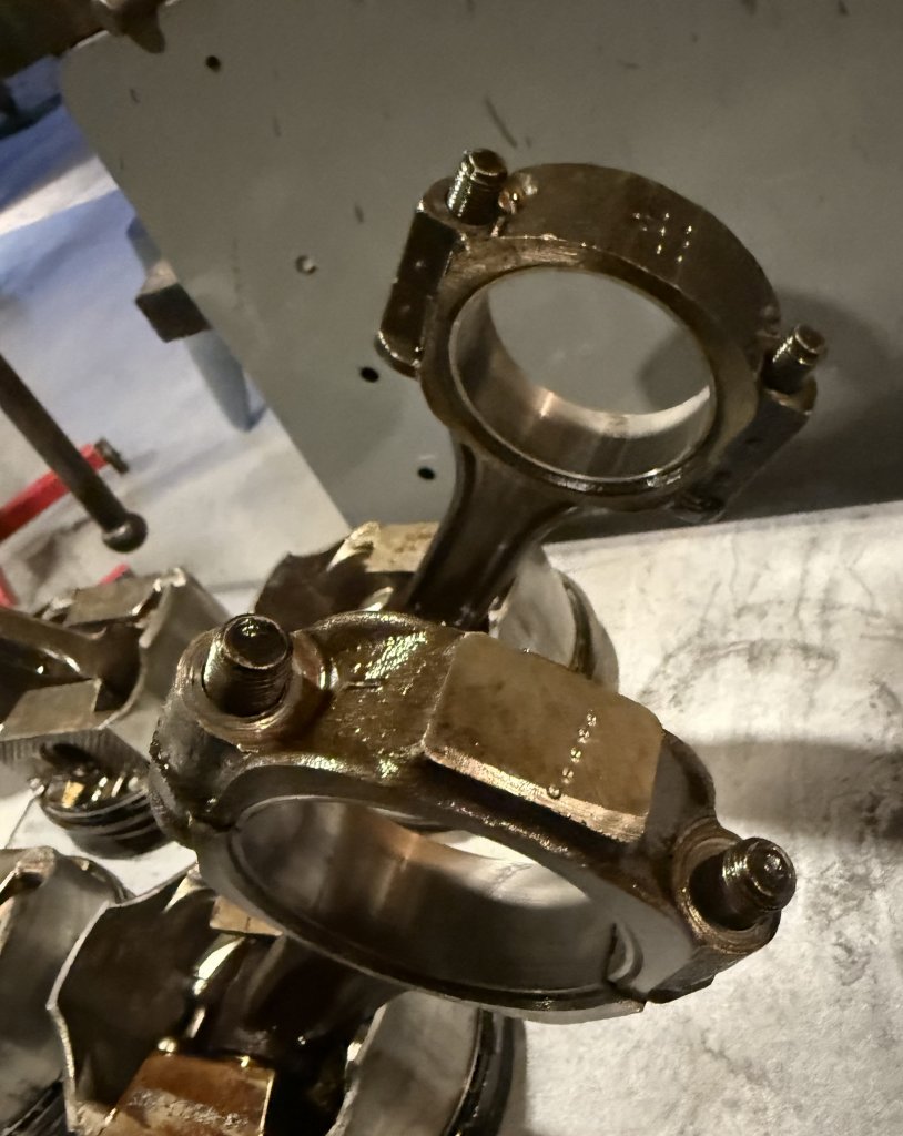

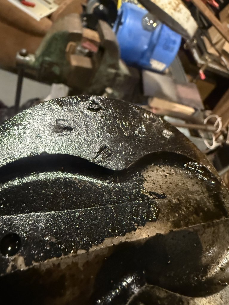

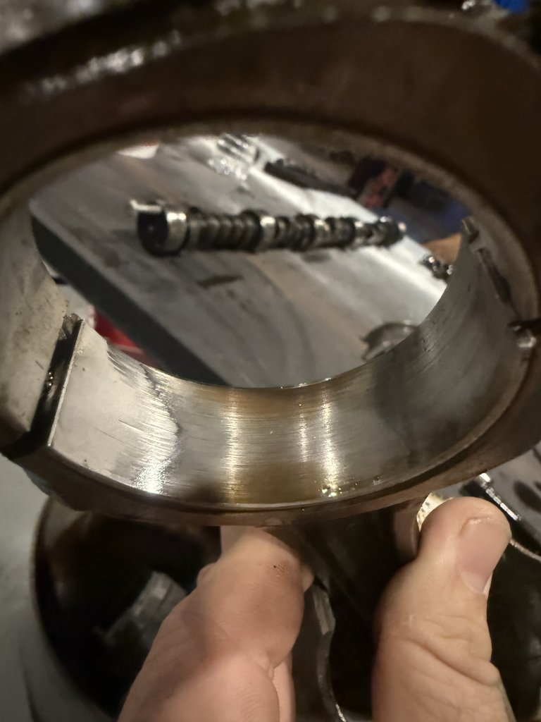

I finished pulling the engine apart today. Number five cylinder has a broken ring and a broken piston. Some of the broken pieces are stuck in the top of the piston. I don’t see any contact on the bottom side of the valves. That’s the only piston that has problems. It’s cylinder has absolutely no markings indicating there was a problem. None of the cylinders have any scratches that can be caught with a fingernail, and there are no raised edges at the top.
The main cap bearings look outstanding. The rod bearings have some copper showing throughout. The crank looks really good, no markings. It was a new crank back when we had the machine work done originally in 2010. Looks like 010 bearings. So a turned crank. I guess.

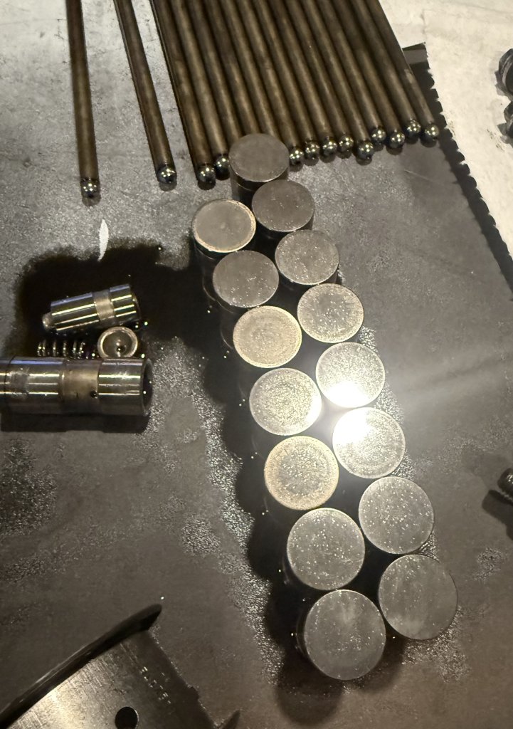

The cam and lifters show 0 sign of issues other than a little discoloration on the lifters. But all the lobes are there.
So other than the broken piston and the broken lifter, no real issues that I see anyway.
I’ve had a few gearhead friends that I called tell me they’d do a good hone on the cylinders, new rings and bearings, and roll with it.
What would you do? I don’t see anything that really warrants machine work, at least for a low RPM cruiser. I decided I want to go roller cam and I’m going to call a cam company tomorrow. I’d like to do the obvious cam, lifters, push rods, rocker arms, springs, and seals. I looked up a video on how to lap the valves with a battery drill on low speed and some compound and it looks easy. My friend has a ball hone for the lifter holes, we had a little bit of trouble getting them out easily, but he said we could hone that out.
I guess I need to figure out pistons. You don’t just replace one piston do you lol? So I will need new pistons and wrist pins. I just noticed that my rods don’t match. You can tell by the Rod caps three of them are different. But they all came from the machine shop like this and I don’t remember what the reason was or why. Maybe that good wrench crate motor had them in there like that to begin with. I just don’t remember. I’ve heard horror stories about those. The important thing is it was all board and balanced as a kit from the reputable machine shop that we had in town. He has since passed away.
Should I buy a whole damn new rotating balanced assembly? You can get the whole kit with the one piece rear main seal like I have, bored 030 like my block, for $1200. I would still have to buy the cam kit. A roller cam kit for these is like $1000….not to mention the rocker arms (I just want better ones than stock like 1.6?) and whatever else.
If I do the whole rotating assembly and roller cam I’m probably looking around $2500. I can already use all the accessories, front cover, oil pan, etc. off the 283. I will need center bolt valve covers, but they don’t have to be expensive. In my mind that gives me a solid engine that will last me decades if I want.
On the other hand, do like my friends say, new pistons, rings, bearings, a good hone, do the roller cam, and send it. Which means I’m probably still in it $12-$1500.
Of course, I could just do the hone and the re-bearing, and re-ring, in a decent flat, tap it cam, and on my way. Or, the rotating assembly and a flat tap it cam, and save the thousand dollars for the roller.
Basically what I’m asking is for direction lol. Based on these pictures and the info, I have given you, what would you do if you have this engine out right now and wanted to make sure it lasted for a long time.i have the money to do this now. I just don’t know.

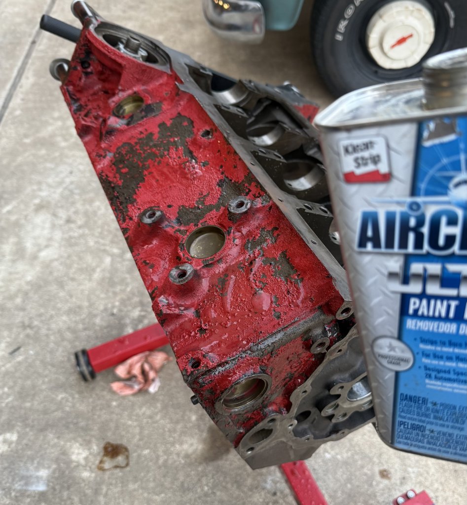

More

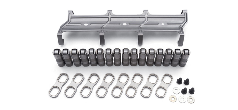

I'd have no problem putting 1 piston in it if I could get an exact match,including weight within a couple of grams or too heavy so I can lighten it. Doing that right now on an engine. Next time lifters that don't want to come out,bring them all up,tape them up. Pull the cam push the lifters out the bottom and remove. Lifters can mushroom and burr on the bottom and you score up the lifter bores trying to remove them. On the lifter bores,don't start with a hone,some solvent and a scotch bright pad,then check clearance with your new lifters.Then if some are tight use your hone.As for the roller cam,go to pick n pull,grab everything off an LT1,Vortec,or roller TBI except the camshaft. Lifters,Spider,Dog bones. Springs,Timing set and cam retainer if you are ambitious otherwise just buy new. Buy new anyway if the chain is sloppy and or going with much cam . Then you can buy a roller cam of your choice and be in it cheap. I have no problem doing rings and bearings on engines that don't show much wear.
35,429
44,745
I'm with Rick, no harm in replacing the just the one piston if you can get a match.
If you don't want to trust used roller cam hardware, it's still available from GM.
The nice thing about the original GM type roller cam setup is that you don't have to worry about seting up proper camshaft endplay.

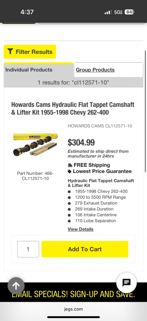

Called Howard’s today this is what they recommended. Said nice upgrade over the comp 206-2 I had, and not stupid crazy idle like the thumper
I’d like to go roller, but I just can’t afford it since I’m about to buy that Tremec 5 speed
