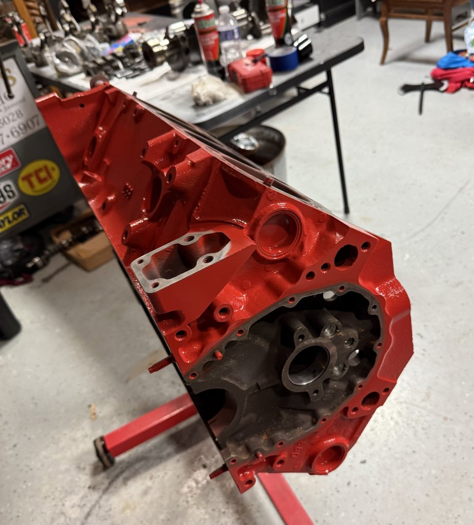

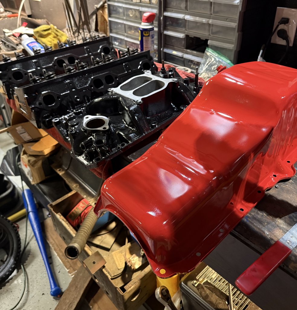

Massive amounts of work to get this crusty exterior ready for assembly. Scrubbing everything with degreaser, I already had ARP head bolts in, had to get all the old coolant passages sealant off of them. Had to use aircraft paint remover on the block and heads to get two layers of red and one layer of black off. I didn’t want to do orange on this engine, but then I saw an engine with an orange block, black heads and intake and polished valve covers and I thought that looked cool so that’s what I’m going to do.
Tomorrow I’m going to borrow my buddies valve spring tool, the two that I have only worked while the head is on the block. I can’t keep the valve up while I compress the spring so I need that big C clip one.
I may have mentioned this before, but jegs called me today and said the Howard’s camshaft and lifters won’t be here till April so now I’m back on the train looking for another cam.

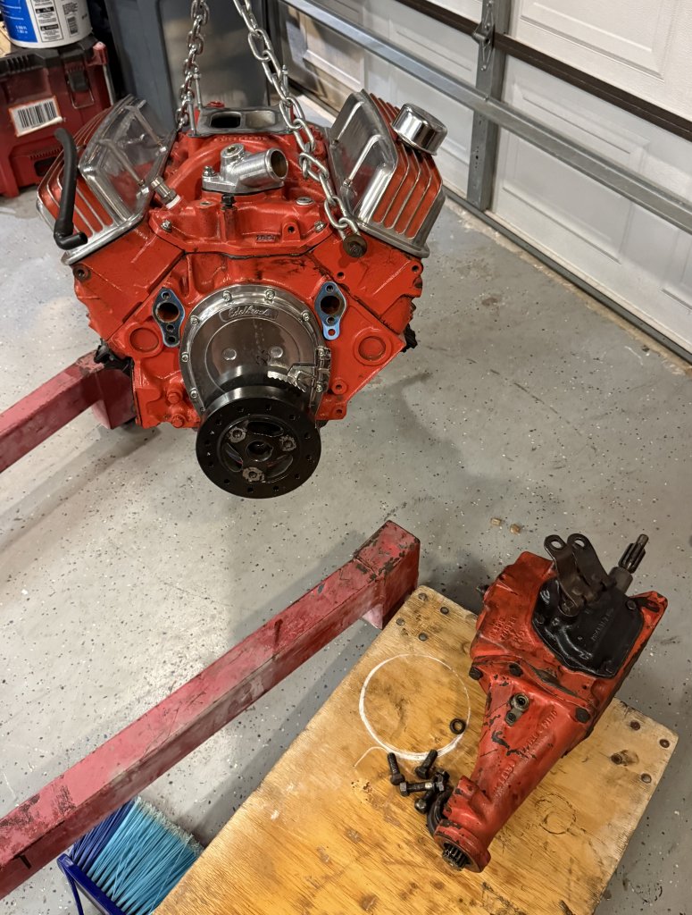

That’s one 283 and 3 speed that will never hurt me again lol
