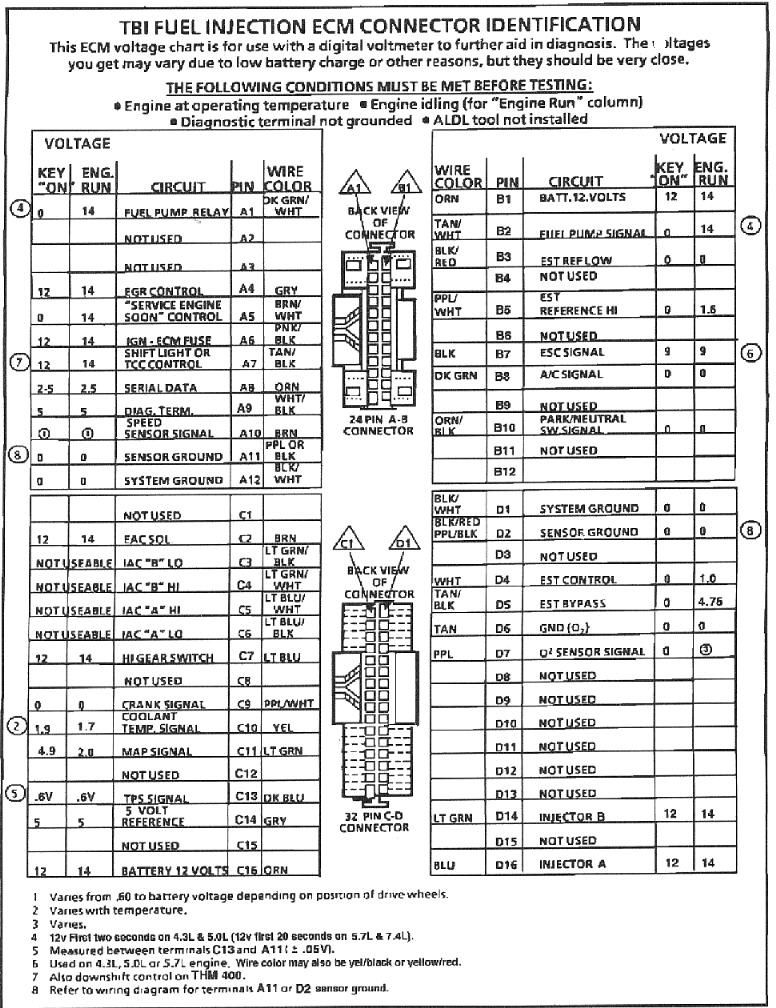

All the wiring diagrams are in the injection forum on binderplanet.com
Here's the pinout with the key on test you can perform.
Just back pin the connector.
I normally remove the blue comb to make it easier.
So, unplug connector from ECM, find pin D7 and read it from connector to your O2 connector.
Then check the O2 sensor gnd to eng gnd.
Error codes are based on specific criteria.
Normally you won't get an O2 error until you drive it fully warmed and the ECM is waiting for a specific reading.
This can also include VSS input like the EGR test uses.

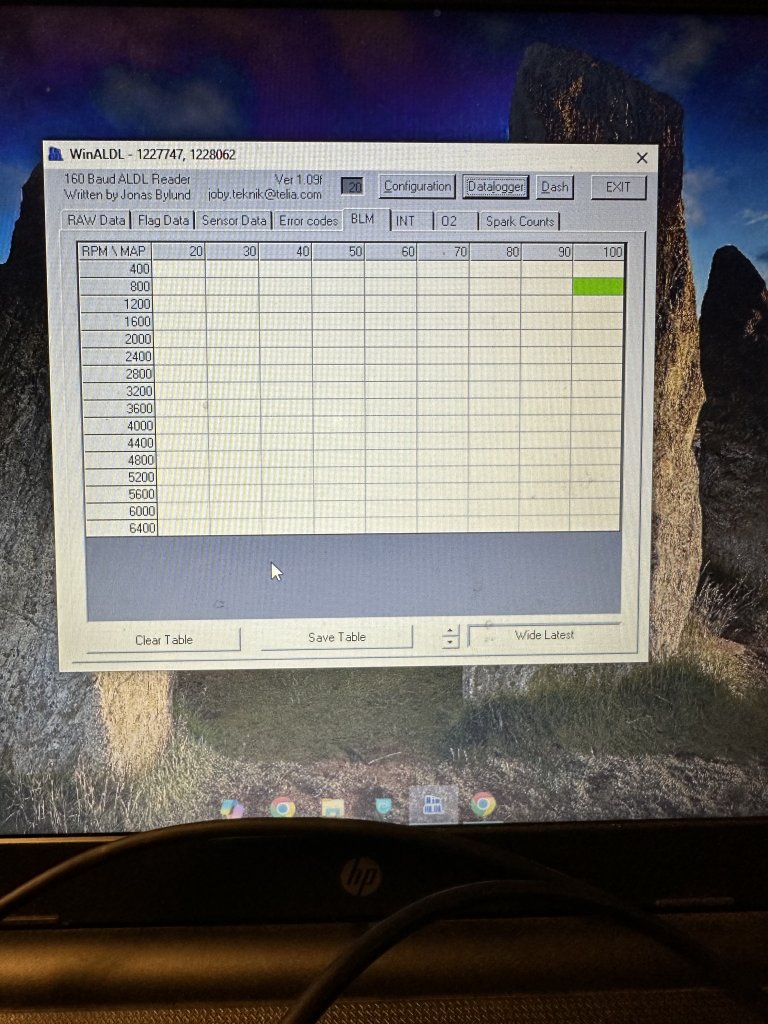

I went ahead and installed the 3-wire O2 but just rigged up the power to it temporarily. There are more O2 sensor readings now, but it doesn't change a lot.
It still populates zero cells in the BLM or INT tables. I don't know why. It does populate the O2 table cells though.
I took a short drive up the country road and back and logged with the 3-wire O2 active, log attached to this post.
You're still showing an O2 error and it is still not reading correctly. If it does not increase to 600mv it will not go into closed loop with BLM enabled on the flag page.
Did you meter the wiring?
TPS looked better at first but then went all over the place.
So you either have a TPS issue or you have bad grounds.
It will not go into idle mode if the TPS is out of spec.
I strongly recommend you start reading pins and wiring and not swapping parts.
Use the sheet i attached and print it out.
Do the key on test and then the engine running test.
Write the readings you get on the sheet so it can be reviewed.
If there's been a lot of hack maintenance done on this truck, then all of the gnds and gnd straps may not have been reattached on the back of the engine.
The harness can have 1, 2 or 3 gnd ring terminals that contain the system and sensor gnds as shown on the pinout.
I have also seen them attached with the wrong bolt and the bolt is tight but the ring terminal is still floating loose.
