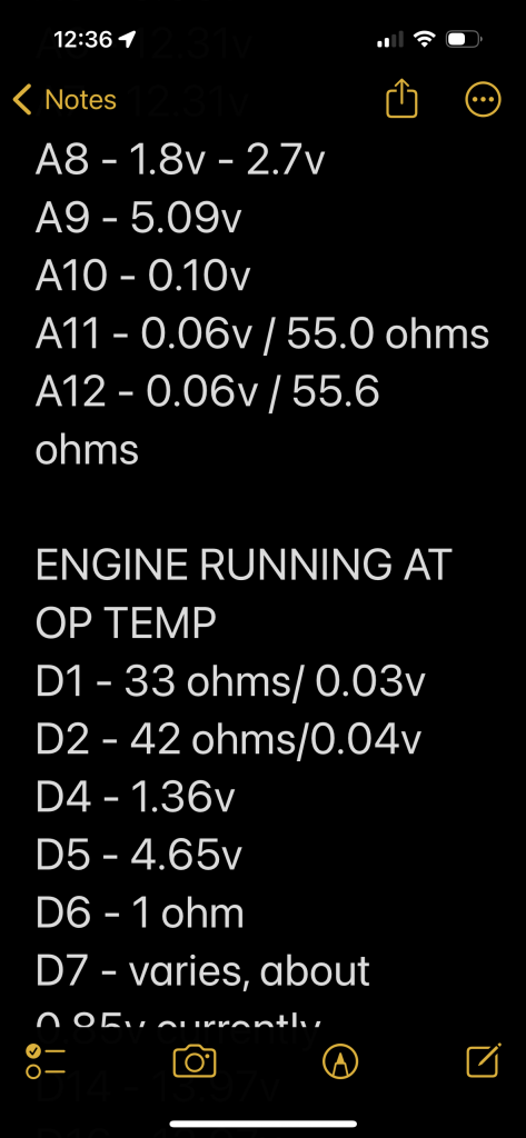

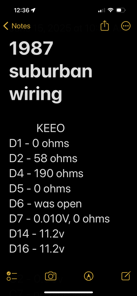

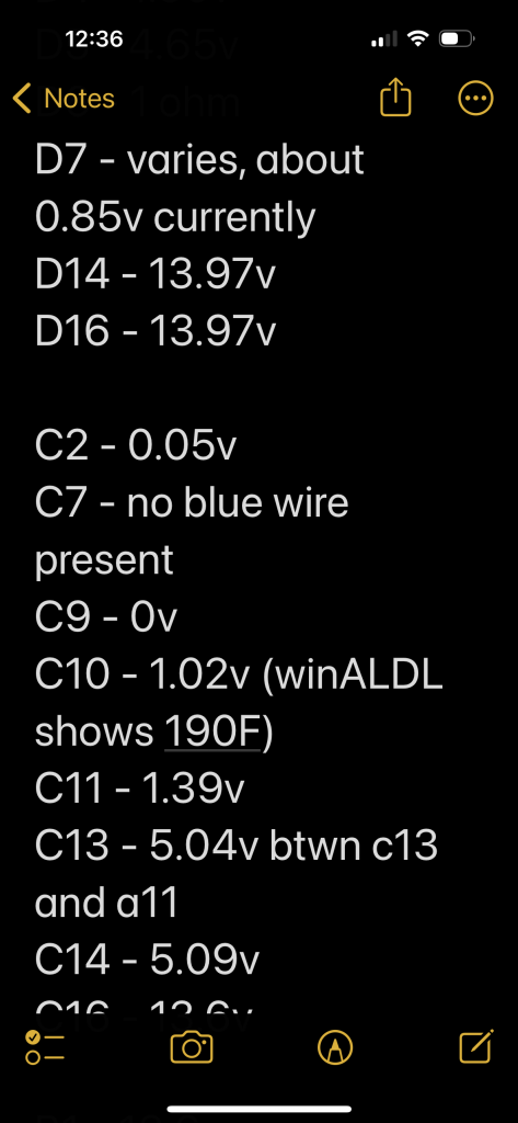

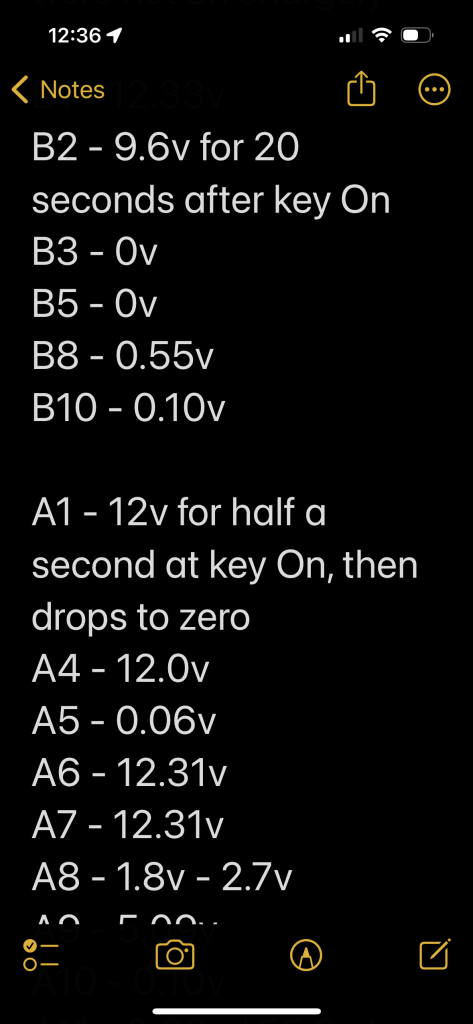

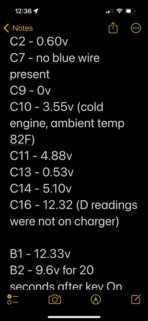

Bill, here are the voltage/ohm readings. The key on, engine off readings were taken cold.

Oh yeah, the O2 sensor ground (pin D6?), was NOT present previously. All the results above, and the surging in closed loop are WITH the ground present. I grounded D6 with a jumper cable. O2 reads now, but o2, blm, and int tables barely register.
