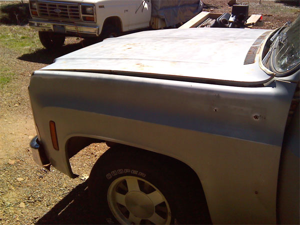

SO, now that I've got things kinda sorted out and the truck on the road, I want to deal with the way the hood closes, as it's been bugging me.. The back driver side corner (near the window) doesn't close all the way, not even getting under the pin/stud at that point...
Is this the hinge? Is it the spring? Is it both?
I don't think it is because the hood is bent, because the passenger side is bent in the same place, the same amount, and it closes all the way and latches under the pin/stud at the rear passenger corner (near the window)..
Also, do the hinges from LMC come with the spring? They don't say either way, but they sell the springs separately, and I'm not sure if this is because the hinges don't come with them, or it's because you can order them by themselves if you don't want the whole hinge...
Here's some pictures of what's going on with the hood..
Driver side, showing the improperly closed hood

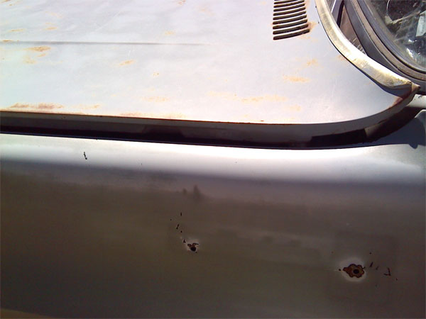

Driver's side, close up
attachment.php

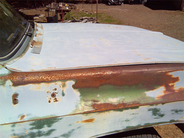

Passenger's side, which closes more like you'd expect...
attachment.php

Maybe try loosening the bolts and seeing if you can adjust it down some. Also make sure that the threads are not stripped in the bolt holes. A ******* did that in my Jimmy's old hood before I got it, and the fitment was crap. I replaced the hood with a salvage yard hood, and it looks normal now. It looks like it'd be something to do with the hinges, but I've not seen one with that amount of discrepant fitment. I've seen the 73-80 style completely ruined, and the fitment was still mediocre.

When I first got the truck, and repaired the door hinge and adjusted the driver's side door, we tried to adjust the hood but could not get it to stop doing this... The bolt holes are not stripped...
I suspect it is the spring, but I'm not sure, and don't really want to shotgun trouble shoot it if at all possible... Hoping someone has seen this and knows, before I go that route..

Mine was like that, I loosened the hinge bolts and lifted the hood and forced it up as high as it would go and tighten the bolts, closed it and it was perfect, need a helper to lift the hood though..

Hmmm.. I don't think we tried 'pushing it up'..
That's interesting....

At first it don't seem like it would work, tried all kinds of stuff and it always came out the same, read it somewhere about that so I tried it and bada bing the hood dropped right in position.

Yep, that's the trick right there.
Also, make sure to lube the hinges real well. And if it still doesn't go down all the way at the back, it might be hitting the tall "safety" bolts at the rear of the fender.

Aligning the hood can be tricky, but loosen the bolts that attach the hood to the hinges just enough to make minor adjustments until it will sit correctly with the fenders. Once the hood is in the proper location, use a scratch awl to mark the underside of the hood where the hinges attach. I marked my hood around each hinge...including the location of the mounting bolts. If you ever need to remove the hood again, alignment will be simple. I had to remove my hood after a problem arose with the paint so having the "scratch" reference helped tremendously with the install.
And as always...don't force that hood closed...those years of square are notorious for the hoods creasing just before the hinges. Now would be the time to install the under hood brace.

You wouldn't think it, but rotating the back of the hinge down pulls the rear of the hood down.

Ah yes...one of the many tricks to try. Hoods tend to be the trickiest to align.
