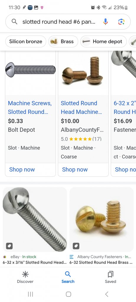

I use machine screws in vacuum hoses all the time, in my opinion they're preferable and cheap. Most of the vacuum plugs these days split on the end in short time. I buy new machine screws and screw them into short pieces of new vacuum hose. But I was letting you know that the one pictured was for ported distributor vacuum advance,which I wouldn't run,so plugged is good. But I need to see where the vacuum advance is hooked up now to see if it's on manifold vacuum. Machine screws are not tapered and the threads aren't deep enough,so they don't split or cut the hose. Pick up a few different sizes to have an assortment on hand.
I have a big stack of Equipco parts bins in my shop - three of the drawers have my machine screw collection (imperial, metric, etc). This screw has most likely held for a decade so it should be fine - I'll just keep a few vacuum caps/plugs in the glove box so that Murpgey's Law doesn't strike...

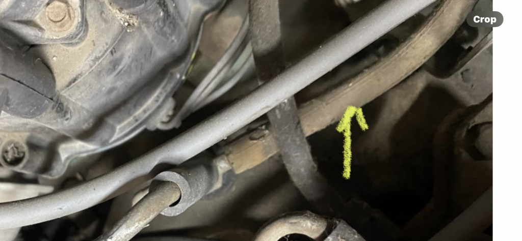

The second batch. I think everything is hooked up correctly. I realize the speedo cables are not hooked up and the cruise control is not in the right position - I have the new inner fenders sitting on the shop floor for Saturday mornings job list.
Hey dude . Where does this vacuum line go towards the driver side ?
I will have to check, and the truck is currently buried in a hung drift - waiting for better weather this week to go dig it out.
My vacuum lines might not be correct as I can't find a diagram for my year, and this was three parts trucks put together by the previous owner

Thanks . Yea so many different set ups over the years and models of GM vehicles it’s hard to find the one you have . Especially if things have been changed over the years . Currently got that line plugged for now
