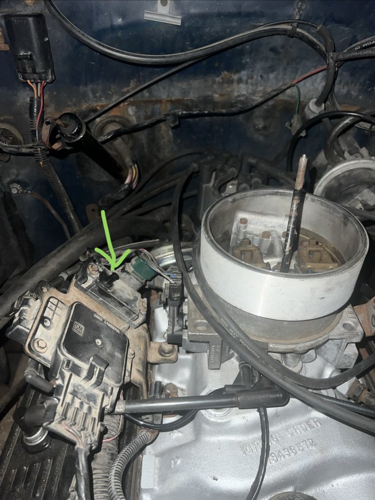

Was having some issues and got a code 45 so started looking at some culprits and found one end on the MAP sensor vacuum hose had some cracks in the boot. Plugged one end with a finger and blew into the other and was getting some leakage.
The nipple on the MAP sensor is straight up into the air cleaner and the other is at the rear of the TBI. What have yall been using to replace these old brittle lines? Finding boots and whatnot at this size has been difficult so far.
Basic measurement with a tape - 3/16” ID, 1/4” OD, roughly.
I know this is a pretty basic question but any suggestions or ideas would be appreciated.

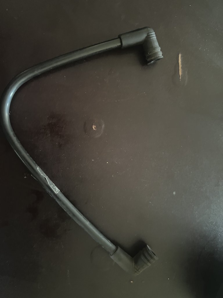

Can a straight piece of vacuum hose of appropriate diameter and length be used, or does it need the 90 degree bends?
There might be replacement vacuum hoses available like the one in the photo as well.

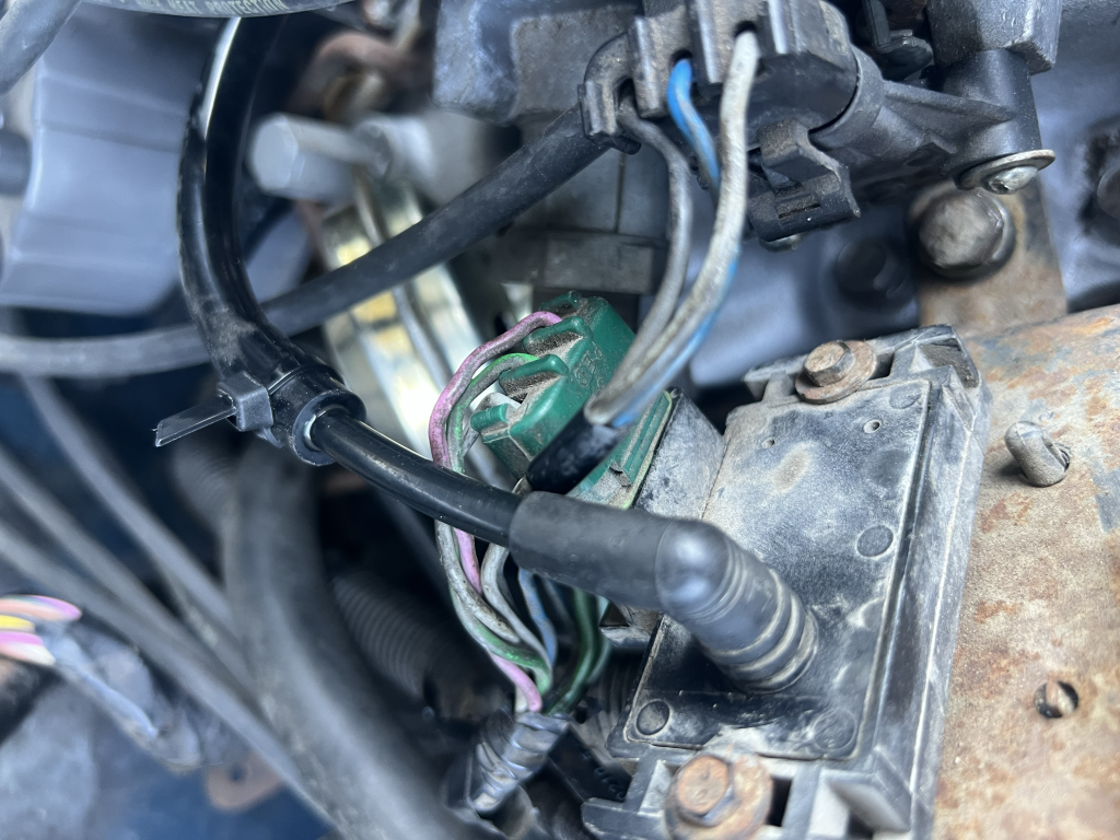

Connecting to the back side of the tbi would be fine straight but connecting to the MAP sensor itself looks like it would need an elbow of some sort. With the air filter on there isn’t much room over there.
Seen some similar parts for newer models but hose/boot specs aren’t listed. Will give them a call tomorrow and see if they have the info.

Thanks for the responses. I’m all for replacing them with silicone tubing. My main issue is that MAP sensor nipple they points directly up into the air cleaner. Using straight tubing on that one will surely kink.
Think I can temporarily take a boot from the evap canister for the MAP sensor but would like to find a permanent solution to that one hose. Evap canister will be replaced with new hose.

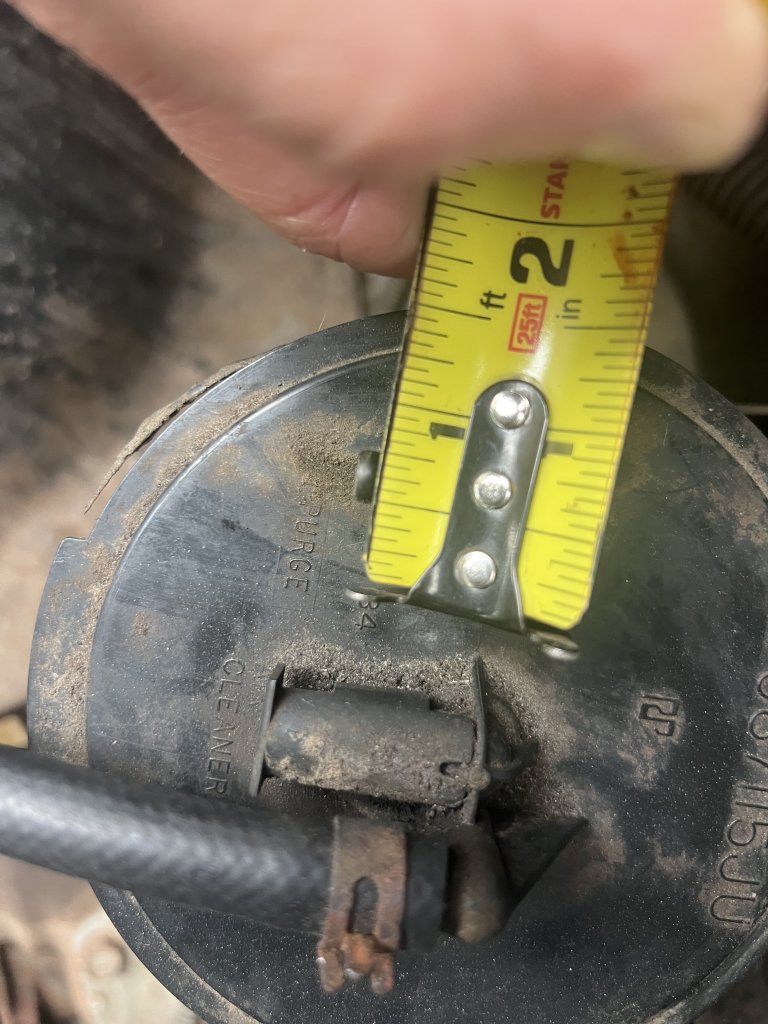

Although the original inner diameters of the hoses on the truck were 5/32 and 3/16 it looks like I would need 1/4” tubing if I switch to silicone.

I just replaced the same thing on my truck over the weekend. 5/32 silicone worked well, and no kinking issues, but I'm running an Edelbrock air cleaner with a 1" spacer ring on top of the metal factory ring

Thank you all for the suggestions. I had a 1/4" line on there but wasn't 100% happy with it and this is what I've settled on for the time being. Basically what y'all described - boot, hard line, 5/32" silicone tubing. Still not 100% happy with it as that boot thats on there is one of the originals but it should hold for now. Blew through each end with the other plugged and didn't feel/hear any leaks. Also swapped out quite a few of the other vacuum lines while I was in there. Only one that remains is the EGR to TBI line as the EGR end is 5/32 and the TBI side is more like 3/16.
