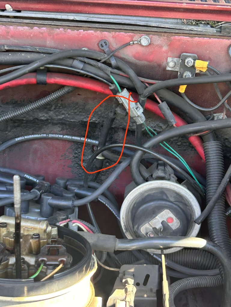

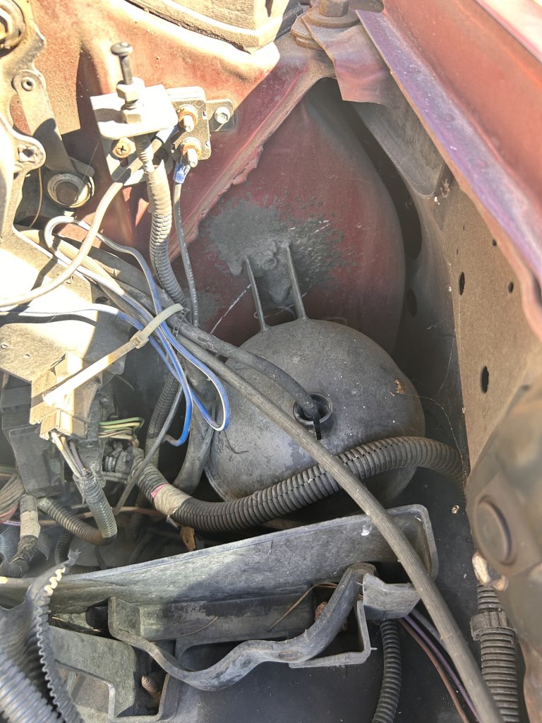

I just finished doing the spark plugs and wires on my 91 suburban and now it runs like crap. I did find that I’ve broke the vacuum line going to the vacuum ball reservoir because it is incredibly brittle. And if I plug the broken line with my finger, it does run smoother but still misses just a little bit.
Are there any other ones I need to check that would be inherently an issue that I might’ve snagged? And what other vacuum lines connect to this splitter section by the firewall? Pics of where I’m talking

On my 91 that splitter you're talking about has a line to cruise control, to the round ball you're talking about, a white hard plastic line that disappears into the firewall right above the passenger side valve cover, and one that runs down to the top of the intake behind the throttle body. No AC on this unit if it matters. Not sure that's going to answer any of your questions though.
