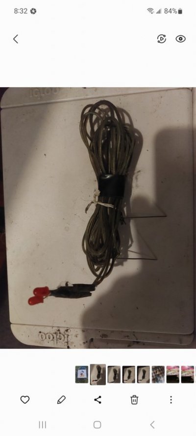

Okay,I've talked about this before but finally got around to taking a picture. That's a homemade noodles light/test light. That's about 12ft of 2 conductor speaker wire,2 leds twisted in opposite polarity,remember leds are polarity sensitive, they won't light if they get power reversed that's why two twisted in opposite polarities. 2 T pins. You slide the t pins in the backside of the connector you don't even have disconnect anything,string the wire somewhere safe and hold the bulb end down with the wiper blade. Now you can see from the drivers seat if you have a working circuit,you can even test drive for intermittent problems. If I had been thinking I would have used 2 different colors,hooked it both ways and noted which light lit with power in which direction,so I'd know which side was power and what side was ground. Ignore the bread twist tie,it's just holding the bundle. I need 2 new LEDs and radio shack is gone,and the ones I bought from. Ebay are junk. Where do I go? P.S.. it's LED so it's safe for the ECM.
I get everything from Amazon... Something like this might be easiest. If you wanted a mini project, you can get the bare LED's and a handful of resistors and make a Christmas Tree style light that shows you if you have 4v, 9v, 12v or 14v (I'm just throwing out some levels that might be useful) and which polarity it is.
I've rigged up similar setups but it's always been temporary. I ought to do like you have here and make a permanent tool. Good idea.
Thank you.

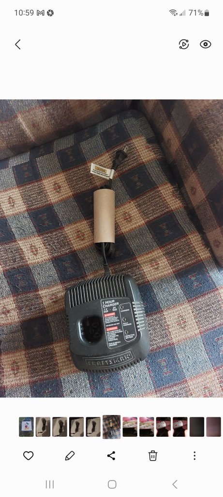

I was putting a charger up the other day and didn't know if everybody knew this trick. You could use napkin rings or short pieces of pcv but the toilet paper tubes are fancy enough for me. I like it cause I can just pull the cord and I've got it ,and putting it back up is easy,no looking for tape,no having tangled cords next time you go to use it.

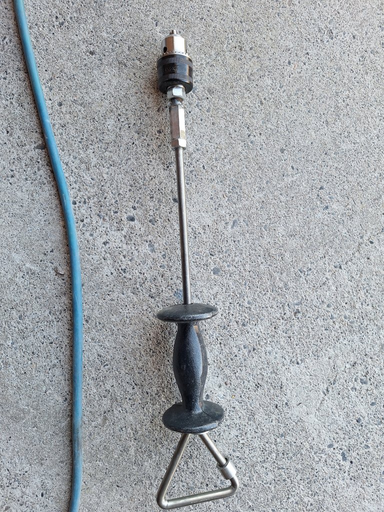

For those who have fought the slide hammer for pulling dents with a stud welder not gripping the pins, especially the garbage one that comes with the Harbor Freight kit. I took a 1/2"drill chuck and adapted it to the slide hammer. Slide it over the pin, grip the outside of the drill chuck, give the handle a quarter turn to grip the stud, and get after it. Works great.
