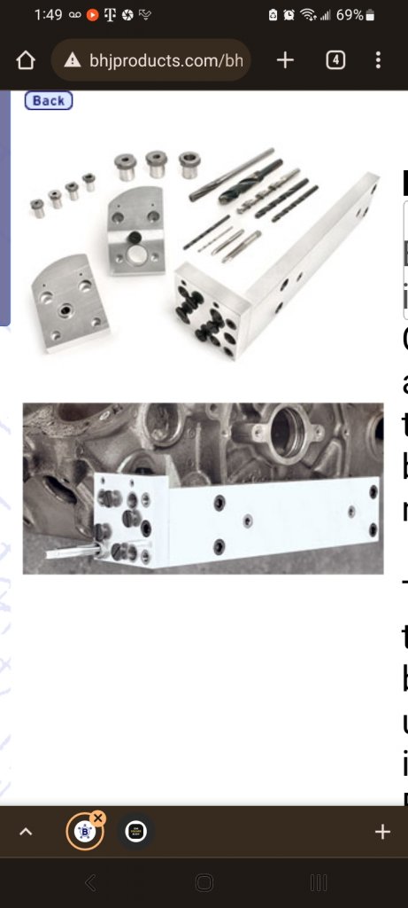

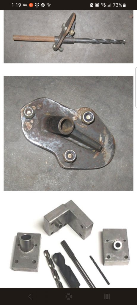

Tools for drilling sbc fuel pump pushrod. Jigs Ive found on the internet for anyone that wants to try drilling a fuel pump rod.Turns out its hit and miss on how later model blocks were finished ,so the jig that works for 1,may not work on another.It seems some have bolt holes and a partially drilled push rod hole,some have bolt holes but no pushrod hole at all some have no bolt holes or pushrod hole. That last jig locates on the timing cover pad.All could be fabbed using a bare block with the pushrod hole to reverse engineer the pushrod angle and bolt locations.The L shaped jig for drilling the bolt holes could easily be fabbed using a piece of steel strap approx.3 inches longer than the aluminum pictured with a 3x3 piece of angle welded or bolted to it. The jig for drilling the push rod hole is self explanatory.
