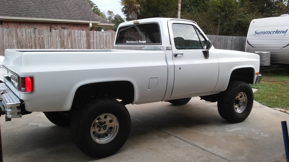

So I'm pretty sick of my truck. I've never been a big 4x4 guy and I bought this truck in a panic after I totaled my red C20. The four wheel drive doesn't even work, there's no front drive shaft and the front gears are 273 whereas I put 4-10s in the rear. It has like A 4 inch lift on it and rides like dammit. With the 35s the pavement is loud, even with sound deadener all over the cab and carpet. I just never even want to drive it anymore. Even though I have it lined out pretty well, I could drive it anywhere 90 miles an hour the whole way. I get tons of looks and thumbs up because everyone loves the four-wheel-drive look.

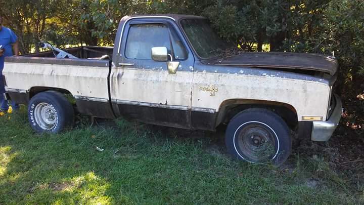

I bought a short bed 2 wheel drive truck for two hundred bucks. No motor no trans and the rear axle has issues. But I was thinking I could take the front crossmember out of it and put it on my truck, and swap leaf springs in the rear or whatever I had to do, get rid of the transfer case, get rid of the 35s and basically have a stock 2 wheel drive truck.
With my engine in a lighter 2wd truck it would be nasty. Plus ride wayyyy better.
So a few questions. Once I take out the transfer case I'll have to do something to the 700r4. Is there a tail shaft I can add? Then have the driveshaft fitted.
Are the holes for the 2wd front crosssmember already in the 4wd frame? I have not had a chance to look.
Is there any way to easily convert my rear 12 bolt axle which I like to 5 lug from 6? I hate to have to start all over on a new axle when I just put 4.10s and the Eaton lsd in it.
Anything else I'm missing?
