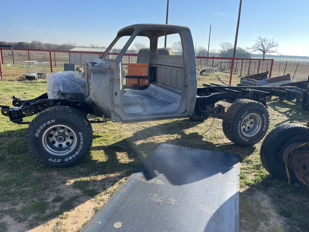

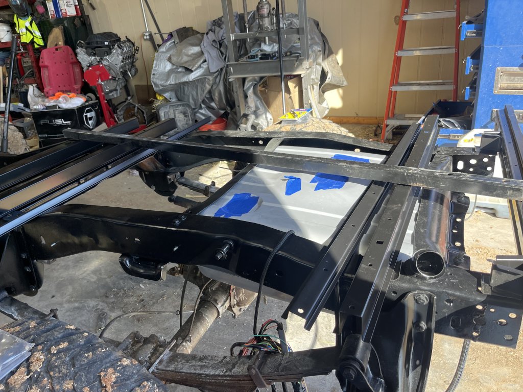

I’ve been doing a c10-k10 conversion. I found a Blazer frame for the axles and some parts and bought the rest from eBay/LMC/ORD. A frame swap may have been easier but I was given the base C10 so figured I would roll with it. You can do the front end without even taking the body off the frame.
Also, adding a blazer tank in the rear using the blazer crossmembers.
