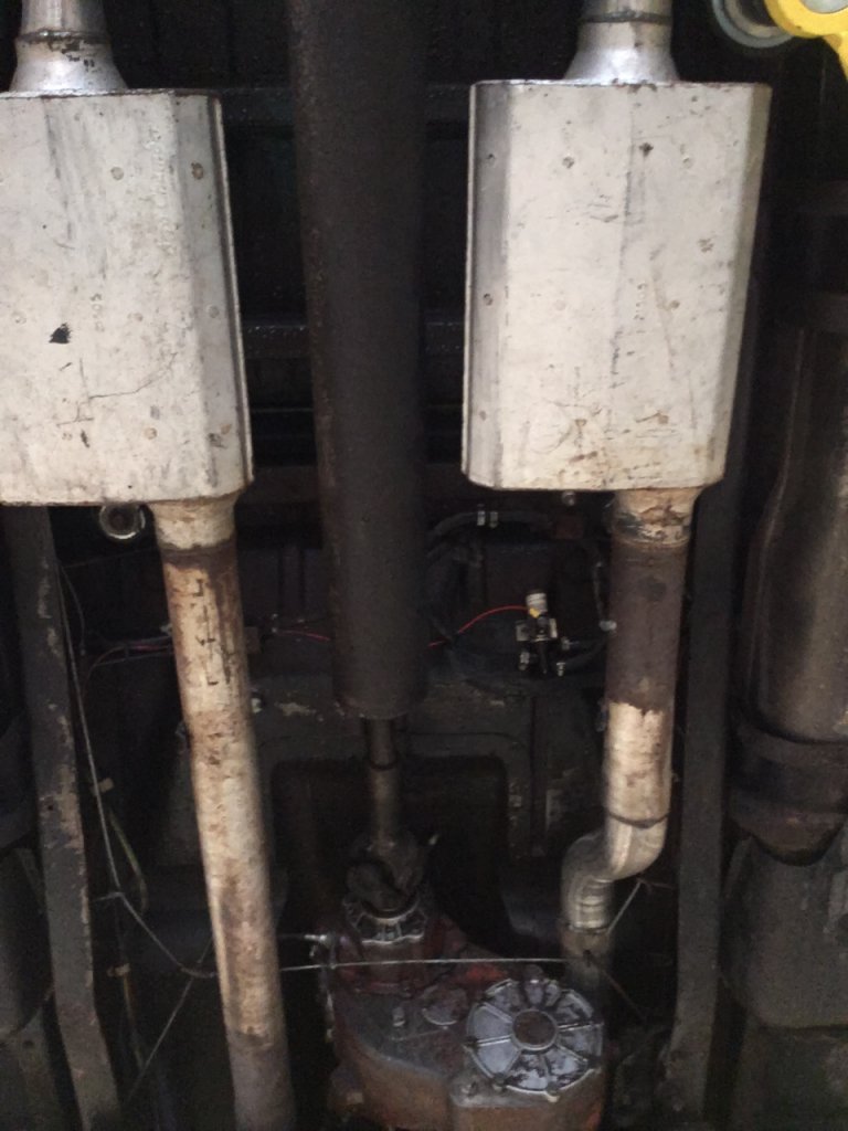

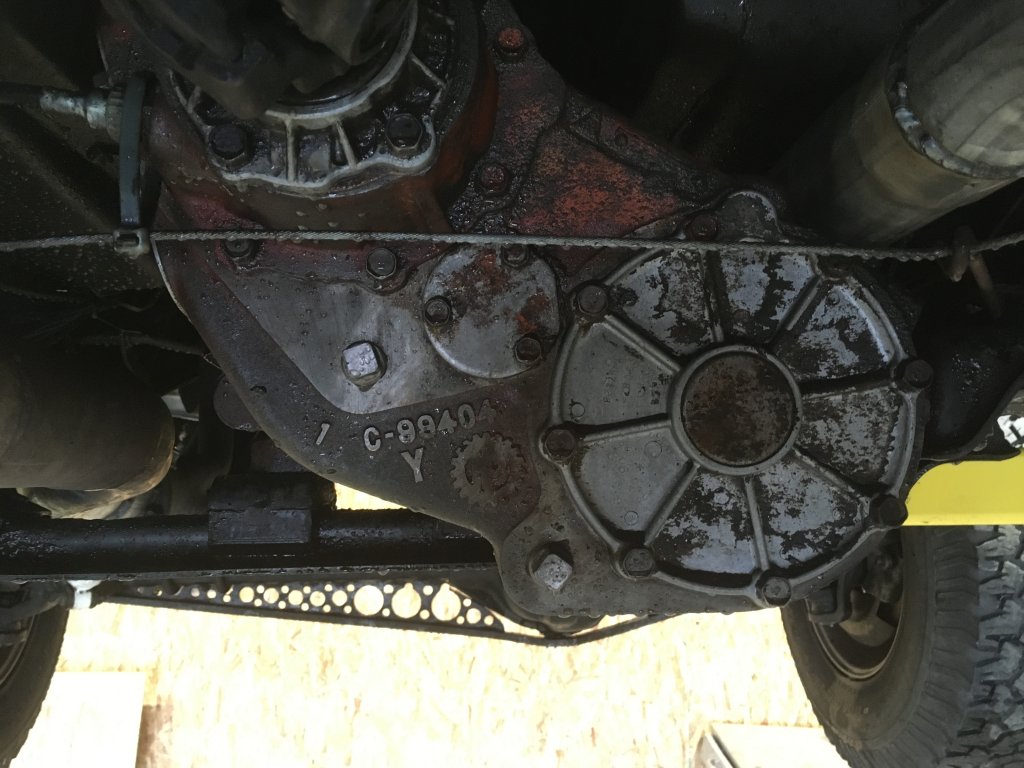

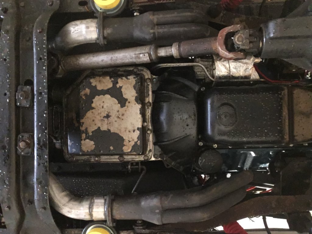

Here are some pics from a 1973 K20 W/205. 203 will be almost the same, not sure about the 208. I would do as you said in your #15 post. Install it first and see where the obstruction is, then modify if needed. Notice the last pic, the hump has plenty of room around most of the Tcase.
This is very helpful! Based on the last photo, I am less concerned about the width. Maybe a 1" body lift would be a good option for height clearance.
