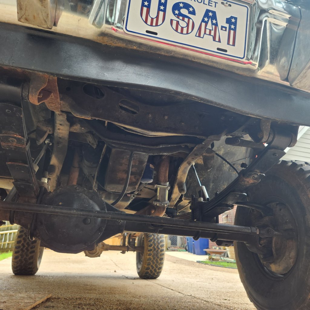

Decided this Rough Country 4" lift is a little too much for my taste. Thinking of going to a Tuff Country 2" or 3" kit. Truck won't see a lot of off road (it's for the wife). Wondering if I can still use any of the already installed parts and are any of them replacement to begin with. Steering arm? Pitman arm? Shocks? Pics below. Also comment if you see any issues. Thanks

That pitman arm (on the gear box) is stock.
That steering arm (on the axle) is for 4” so it’ll likely be too tall for anything less.
A 2” drop pitman arm and a stock steering arm would work.
The stocks are ok for 3” and possibly 2”, it just depends on if the new springs are true to advertised height (Rough Country can also be tall).
Were the driveshafts lengthened with the RC lift? 4” is a borderline height for lengthening mods so check that.

So it looks like anything 3" and below doesn't come with a steering arm. Guessing I would have to come up with a stock replacement?

Correct. If you go with 3" I'd consider a drop pitman arm or a 2" drop drag link (they make 2" or 4"), you really only want to have about 1" or so of downward rake to the drag link. If you go with 2" lift then I'd run all stock steering pieces.

Thanks. Guess I'll start looking for a steering arm since this kit was on the truck when I bought it.

That rough country 4" front spring looks like it sits WAY higher than my Tuff Country 4" springs do. My 4" steering arm and 4" springs make the drag link sit completely horizontal. I have zero bump steer and it rides very nice.
I would think your best time, money, and result would be to swap those rough country springs out for a set of 4" Tuff country EZ ride springs.

I usually agree with @nvrenuf but I am going to have to question going back all stock on that steering arm. I honestly cannot tell how much difference there is in height there but is it truly 4 inches different from stock? He may be right but it is difficult for me to tell by the pics. And he is a very solid source of information. It looks like you have more than one inch of rear drop on that drag link now.

That drag link pic may be misleading with the truck parked on a slope. Bextreme04 has sent me a stock steering arm (most appreciated) so I should be able to go down some with that. Leaning towards the 2” Tuff Country for hopefully ride quality and height. Did a little more research on the sway bar. Understand why it is missing now. Thanks

Close but no... This pic hits a little closer to the mark.
