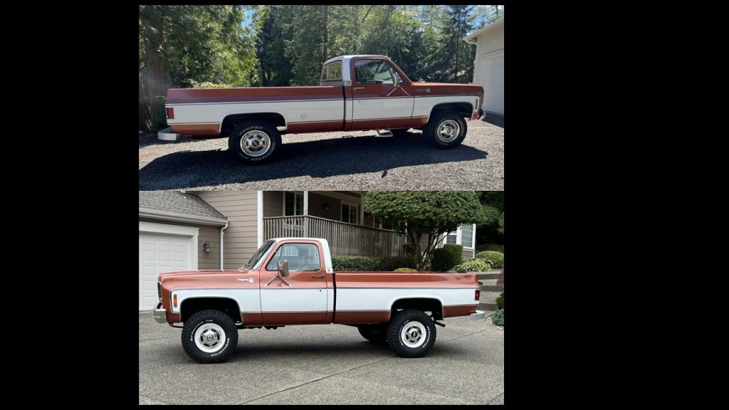

@JimVG
Hope you don't mind me using the pics you posted of YOUR before/after. I also have a K20 that came with a new Rancho 2" lift on stock tires. I just bought some 17 x9 wheels and am looking at new tires in the 33" range. I wanted to visualize the before and after of the larger tires on a 2" lift. If I screwed any of this up let me know. I had to edit it twice before I was fully awake.

@JimVG
Friend, if it's posted on this forum it is Public Domain.
The pics are posted to help folks. If you are using them for that purpose, that makes me very happy.
