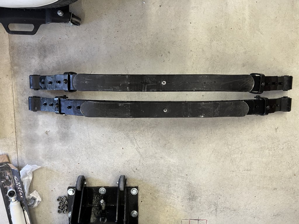

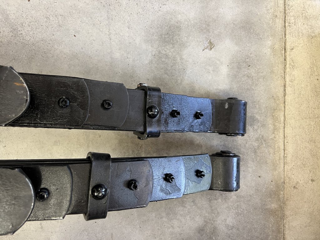

In addition to all of this, one of the rear springs was incorrectly labeled with the correct part number but the wrong spring. I photo documented the obvious differences in the two rear springs, and sent them to both Tuff Country and Suspension Connection. Suspension Connection dismissed the problem completely, stating that the springs were labeled correctly, and the packaging information was correct. This is unacceptable, as the photos I sent clearly show that one spring has a 1-1/2” higher arch and is 1“ longer eye-to-eye.

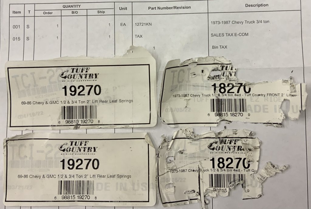

I have attached some pics per your request. The first is a partial pic of the order with the part number labels that were attached to the springs. These labels are correct for the springs I need, and were attached at Tuff Country. Although the order was placed through Suspension Components, the entire kit was drop shipped directly from Tuff Country. The second pic shows the 1-1/2” difference in height as the lay inverted on my flat shop concrete slap. The third pic shows the difference in length. It looks minimal in these pics, but when measured along the arc of the spring, one is about 2” longer than the other. The last pic is both rear springs side-by-side from the top. You can see that the spring clamps are in different locations from spring to spring.

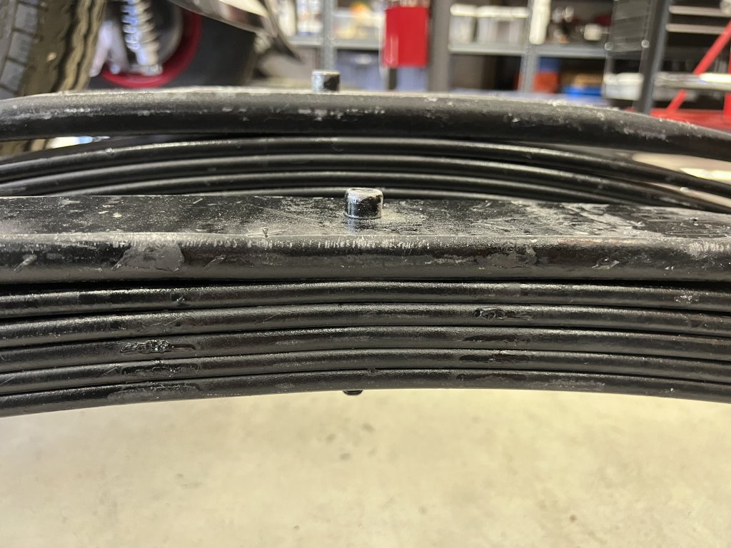

You may agree from the second pic that these are very poorly painted, and definitely not powder coated as I was told. This coating easily flakes off.

I will attach a pic of the Skyjacker front springs as they looked when I got them home. I do think yours like like...well, like Hammered Goat S**t compared to mine. @SirRobyn0 might agree with me on this one...;)

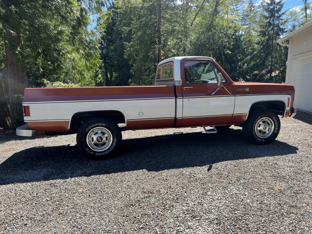

Another major issue is that one of the included rear Tuff Country SX8000 shocks was completely locked in the compressed position, and could not be extended. I immediately reported this problem to Tuff Country, and the tech informed me a replacement shock would be shipped overnight. I received the replacement the next day. Initially, the replacement shock had the same problem, but I did get this one to release.
All (4) of the shocks in the kit appeared to be mis-handled, indicated by scratches in the white paint. One shock had a slightly bent top eyelet. The eyelet sleeves supplied with the shocks are the wrong size, requiring the use of the factory sleeves.
The Tuff Country instructions list installation time as “4 to 6 hours”. Due to incorrect and/or damaged parts and inventory/shipping delays, my truck was on jack stands for 4 weeks.

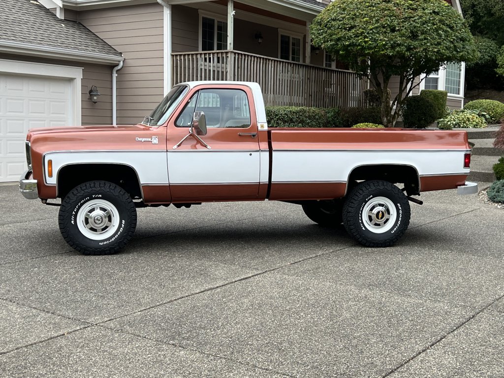

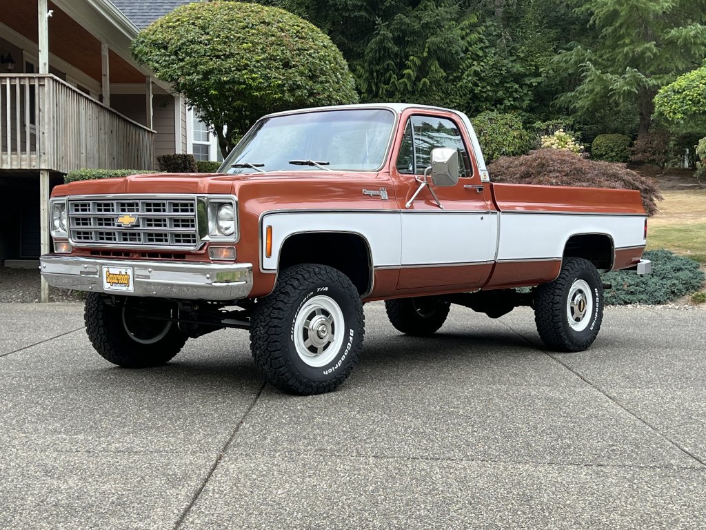

I will have to prep and re-coat the springs in place with fresh paint. This is required to cover the exposed bare steel. Other than that, the installation is complete. Replacing the worn springs with a 2” lift plus 33 inch tires gave the truck a total lift of about 3-1/2”.

@JimVG truck looks great, bummer you had to go through that! Just curious, did you decide to do the 2in lift to level the truck out or for other reasons? I just got a ‘77 K-10 I’m super excited about and the front is lower than the rear. I’d like to level the truck out and put some 33s on it so was exploring the 2in lift option, hence my question for why you went with the 2in. Thanks for the help! I’m just trying to figure out the easiest was to level the front out.

Hello, I decided on a 2” lift because I wanted to use the narrow 285/75/16 on the factory 7” rims. This keeps the tire completely under the fender. It actually measured to be about a 3-1/2” lift combining the lift and the tires.
