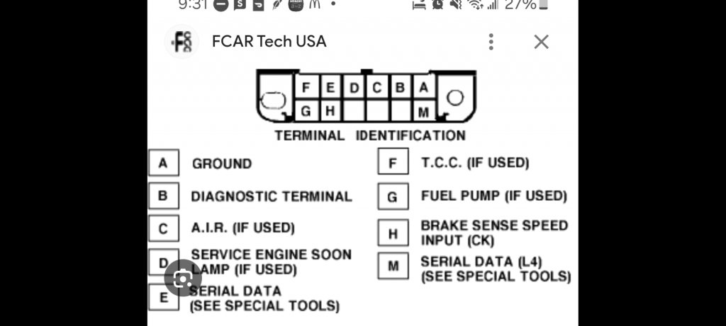

Gm used their own language back then. Your Obd2 scanner isn't going to be able to communicate ,even if you get a cable. Those old GM aldl connectors you short terminal a to terminal b and its flash diagnostics. 1 long check engine light flash 2 quick ones is code 12. So on and so forth. If you use a paperclip make sure it's a real deal old metal paperclip with no coating. Yes I was fooled by a plain looking silver paperclip that had some stupid coating on it once.

As stated, that's not possible. Your truck longgggg predates OB2, you'll have to use the paper clip method posted above
1,636
2,219
Will flash 12 three times then current codes starting with smallest numbered ones first. Each code will flash three times then will move to next code three times if more than one. Back to 12 again when all codes have been flashed. Do not disconnect power until all codes have been read.
Usually the diagnostic procedure begins with lowest numbered code first. Occasionally, one failure will cause several codes. Keep in mind OBD1 systems are not very smart. They do not read misfires, evap and many other failures.
