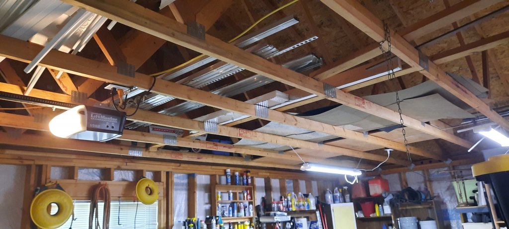

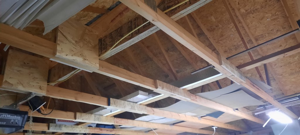

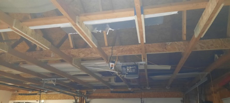

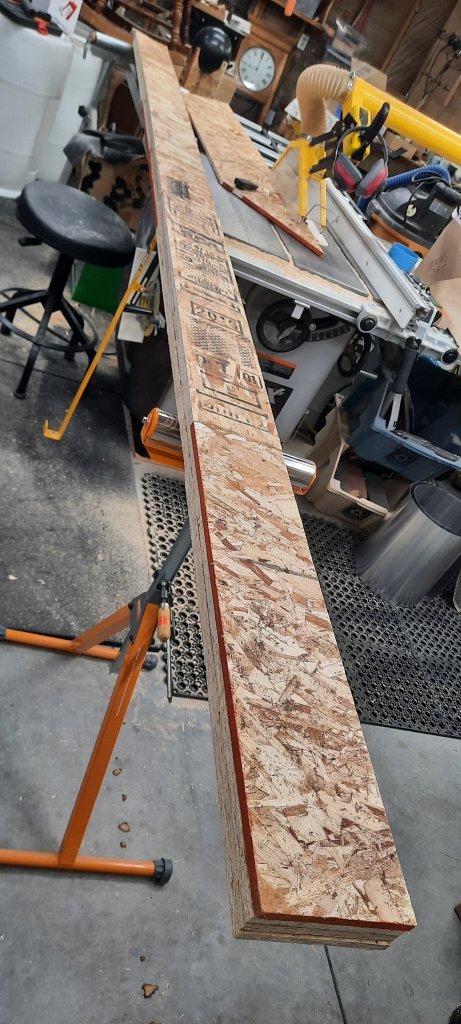

Ordered a hoist from Northern the other day.
I got a whole lot of OSB from the discard piles around the house being built next door. Enough pieces I was able to cover the West, 30' wall, lay some over rafters at the east wall to store an 60's peddle car, Gobo lights, gas torches, trumpet, trombone. . . . and beef up the rafter joints.
Spent yesterday and today cutting OSB for wood plates over factory minimums.

Education, again and again, proves to be an endless thing.
As I look into the minute details of resorting to a hoist, versus relying on a cherry picker and what the factory provides, it becomes obvious nothing is as simple as it seems, if you want to do it well, safely and effectively.
As my posts indicate, I was beefing up the trusses that were not even designed to be load bearing for simple storage purposes.
From there, I considered obvious things like, a metal or aluminum plate over the lambeam I made, to stop the chain from eating away at it.
Next came searching a means of mounting a hoist, and the rabbit trails just grew. Hell, I had no clue of things like, grade 47, grade 70, grade 80 and grad 120 chains, or that anything less than 80 was not to be used to hoist, even though it was fine being employed as a safety measure against loss of a not insignificant trailer and load, or securing that load.
Then came the matter of how to join those chains. Nope, resorting to a grade 8 bolt, a few washers and a nut wouldn't fly, if you wanted to keep you and what you were hoisting safe.
Yep, grade 80 needs grade 80 link methods (duh), but comes the question of what kind are the accepted industry standard.
"Grade 80 Hammerlock/Connex/Chain Connector: These are engineered and rated for connecting Grade 80 chain ends, forming part of chain slings and assemblies for lifting. They’re assembled by aligning the halves, inserting a bushing and pin, then driving the pin flush with a hammer. The connection is strong and secure for critical lifting applications."

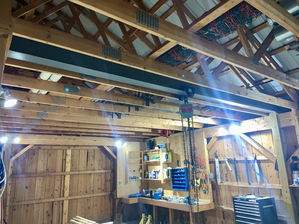

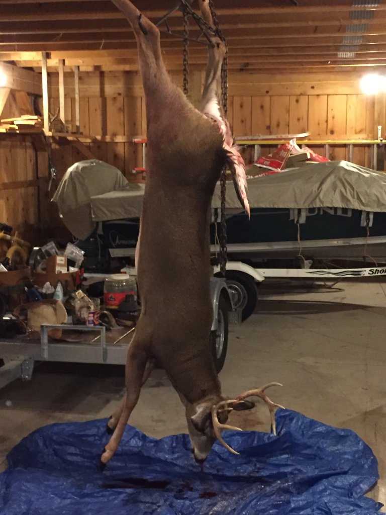

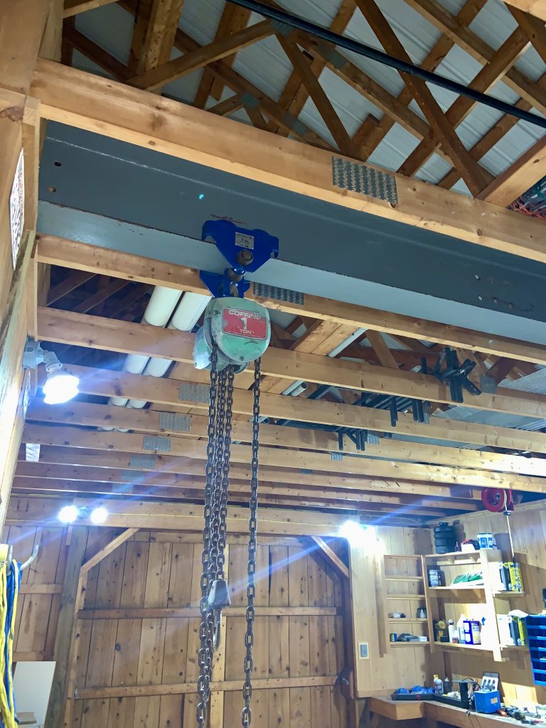

Here's my setup...my brother-in law and I built the 40'x40' barn 20+ years ago. During construction we set a couple of 6x6 treated posts to span 18' for the I-beam I had. If I remember correctly I found the trolley on Northern Tool. Chain hoist purchased on eBay a LONG time ago.
I also used it for raising the box off my K10 so I could clean and paint the frame, it worked slick!
Plenty of other uses...with a gambrel its handy for skinning deer.
