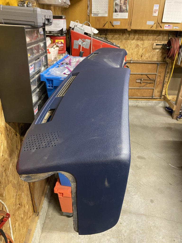

I just purchased a coverlay one and from the top it doesn’t look to bad. But the lower edge and around gauge bezel you will be able to see old dash. It is not full installed in picture just pushed on to check fit. I’ve seen and read that USA1 industries and Cheyenne pickup parts have the best after market dashes. Been told by many that having the original professional wrapped is the best way to go.
