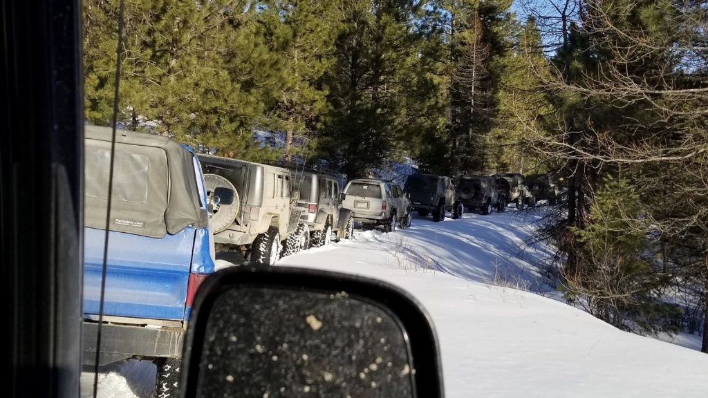

yep, that was what I was thinking. And I've started playing out in the snow again with a group of guys, so I'm wanting to run this bigger 315 in the deep snow aired down for flotation. With my 285/75 KO2 all terrains I got stuck 3 times. I was the heaviest of the group also.
There was a mix of all terrains and mud terrains on that trip. Mud terrains did the best. We had mud, wet heavy snow, then the nasty dry ice-granule snow, then just regular powder snow.
