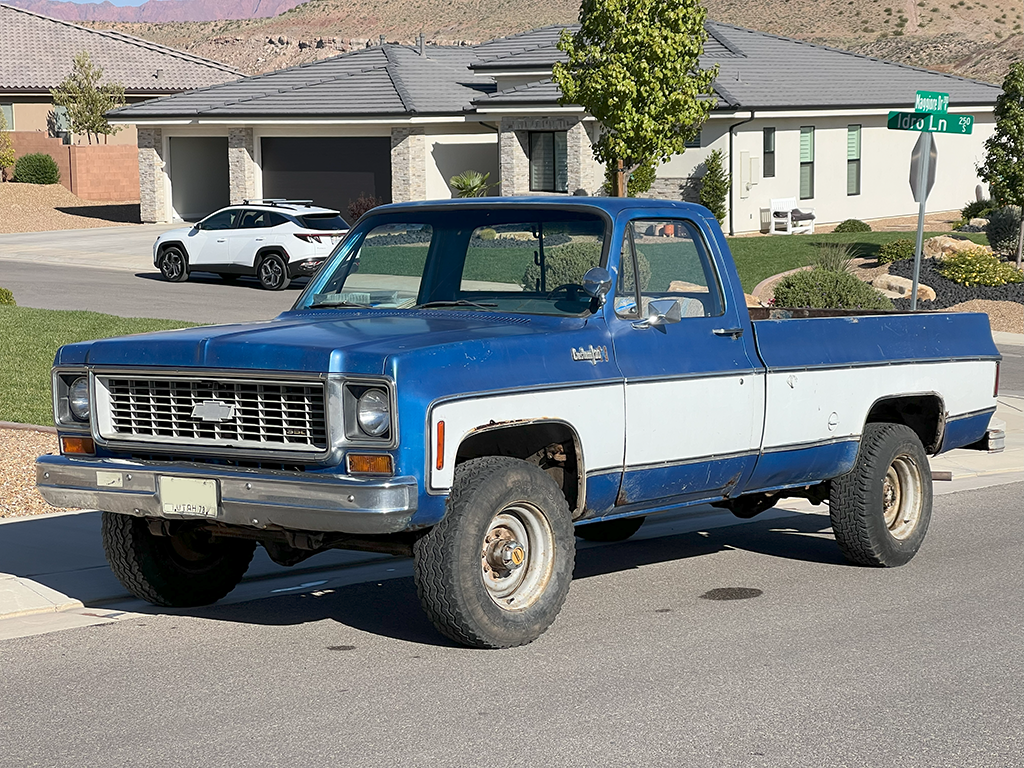

Hi Folks,
I am getting my Dad's '73 K20 Custom back on road. I'll be doing some restoration, but I would also like to drive the truck while working on it. The old Sears tires are heavily cracked. I can't even imagine how old they are. The truck was last registered in 2005. The tires are 9.5 - 16.5. The outside diameter is around 29". I'm hoping I can find a set of rims and tires used that can get me on the road. I've been looking through this forum and looks like I can use a 16" to 17" wheel with a 8x6.5 bolt pattern and a center bore of 5". Some have suggested the max tire diameter of around 31-32". I presume that would be okay with a 10" width. Looking at my wheel wells and current tires, up to a 255/75 R17 or a 265/75 R16 look like they should work. Do I need to worry about offset and depth of bolt hole or can I simply look for wheels and tires with these specs? I don't want to spend a lot of money right now as I may change my mind regarding wheels once the truck has been updated.

Whatever you do, don't pitch or scrap those rims. Those rims pictured are not the standard rims, they are the optional 9.75" wide rims. The resto folks love them. If you want the period correct look, you can still get beefy bias ply tires for them.

@Travir, I was hoping to avoid dropping $2-$3K on wheels and tires before the truck has been restored as I'm not sure what I want now, which also may be different than what I'd want after the truck has been restored. So the thought was getting something cheap but workable for the time being.
@bucket, great reply! I didn't think there was a chance at getting good tires to fit the existing wheels. Thanks! Also appreciate the tip regarding the correct tire width. Thinking now that maybe I should have the wheels blasted and powdercoated white. Hmmmm.......

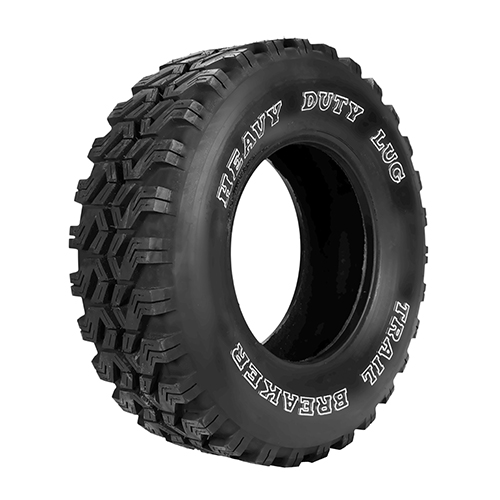

@bucket - not quite sure what you are confirming. I’m guessing the question regarding a 32” diameter and 12” width, not the 33” diameter. As much as I like the idea of powder coating these old 16.5’s, I am growing more hesitant due to the lack of 32” or smaller tire options. I have spent a lot of time searching the internet and have not found a single all terrain 12 / 16.5 that is 32” or under. Both the two you noted above were over 32” for the 12” width. So I may end up bailing on the 16.5’s and selling them to someone who can manage the larger diameter tires.

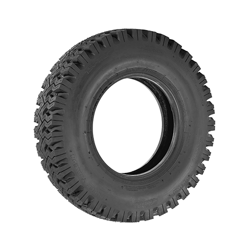

The old tire sizing is funny. The 12.00x16.5 isn't very tall, they tend to be a little shorter than your average modern 33x12.5 tire, at least the ones I have. The biggest issue is whether or not you can deal with a bias ply tire instead of a modern radial. They have their downsides (of varying degrees, just depends on the specific tire model) but have their upsides as well.
Also, I was only confirming that they should fit and clear the fenders fine. My C20 rides a little lower than the 4x4 trucks, and they fit mine.
