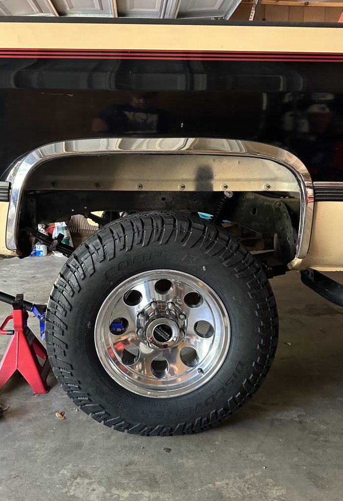

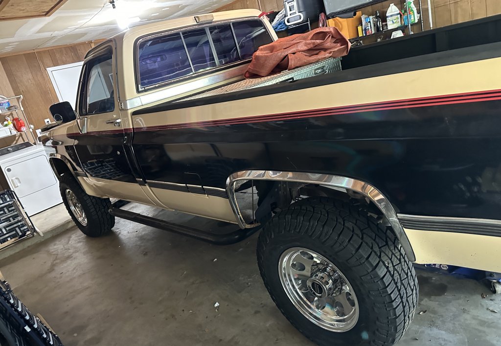

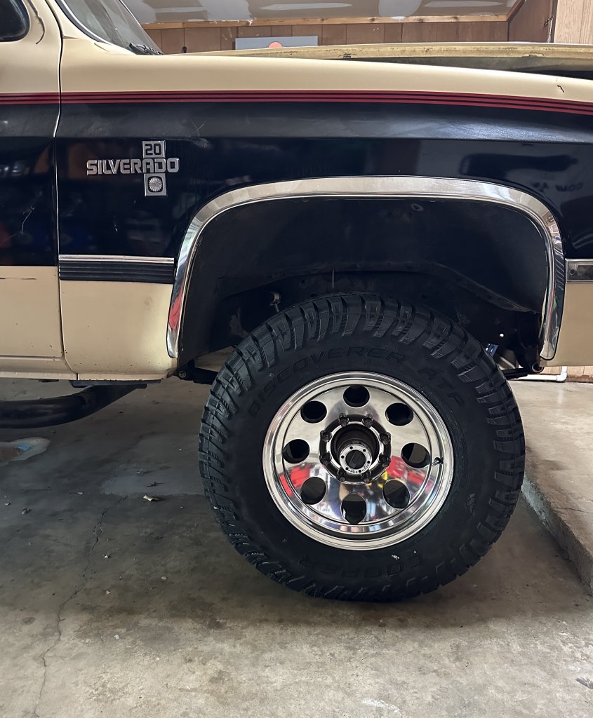

The Oshawa girl has some new kicks! Hopefully I'm doing this right and pics show up. I know they're not the best but I, temporarily, can't move the truck. Still wanted to give an update and show it off a bit. Hasn't had a bath in a while and has been neglected some but I'm finally making progress. She sat in mom's barn for about 3 years.
Want to say thanks again to everyone. They don't just fit well, they look exactly they way I pictured. Wouldn't change a thing. Don't think I would have got here without the feedback and everyone's posts and experiences all over the forum. Thanks again @SquareRoot for sending pics of your setup. Next up give her a bath and figure out how to get the old fuel out that I'm pretty sure is causing some issues. One step at a time.
Edit to give final setup details for anyone else who may stumble on this and find it useful:
1986 K20 with 2" Tuff Country EZ Ride Lift (all spring lift). No rubbing or trimming.
Tires: Cooper Discoverer ATP II, LT285/70 R17 121 E1
Wheels: American Racing BAJA, 17X9, -12mm offset (4.53" Backspace), 130.81mm Bore; 8-165.1 bolt pattern
