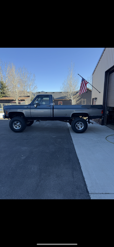

I ended up ordering 16x10’s -25. The specs say they have a 4.50” backspacing with 315/75 16’s. Hope they fit.

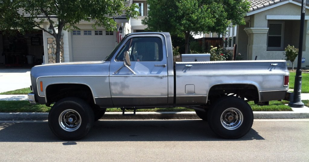

Sorry late in the game here. The grey/silver truck was my '79 K15 that came with an old/stiff Rancho 4" lift. Back then it was wearing 15x10" wheels with 33x12.50x15's. The front fenders were trimmed when I purchased the truck. I went to a 4" Tuff County EZ Ride lift when I did the 3/4 ton axle swap. Tires were 33x12.50x16.5" and the wheels were old school 9.75x16.5". I believe those wheels had 4.75" of back spacing. Those 33" tires were actually 32.8" tall. With the softer suspension, I had no rubbing issues, but I think a 35" tire with that wheel would have.

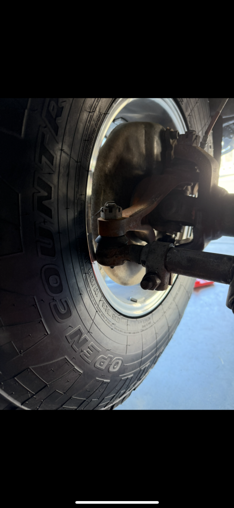

new wheels just touch the tie rod end. Otherwise clears the fenders just fine. Any recommendations on spacers?

I would just grind the tie rod end, just enough to clear. It won't take much.

Mr Gasket makes some thin ones. Just make sure your lugs are long enough.
That’s probably what I’m going with since I don’t need much. Looks like the thread length on the front axle studs is only .93”. Do you know who makes the extended length studs? I can’t seem to find any online.

Years ago I purchased them at Napa Auto Parts. Hopefully you have one nearby.
