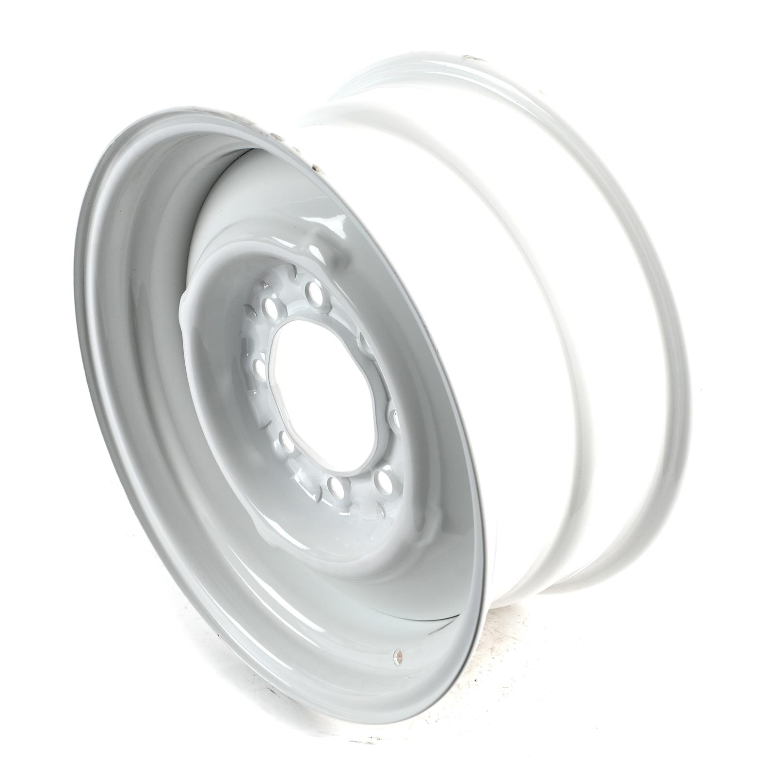

1978 GMC K15 just received a 4” rough county lift and it’s time for tires and wheels. Stock suspension except for the 4” sitting on 255/85 R16’s, wheels are 16x7. I like to hear what your recommendations are to replace the pizza cutters without rubbing. Seems like most run at least a 4” backspace on wheels. Really thinking of putting polished slots on her just can’t decide on size. Thanks!
I have been struggling to decide on any of the plethora of aftermarket wheels for mine, and have yet to pull the trigger. I am definitely leaning heavily towards the stock look with some U.S. Wheel 664 Series 17x8 with a 5.5" backspace.
I also came across this wheel visualizer where you can see a side view of your truck with a couple hundred different wheels.
