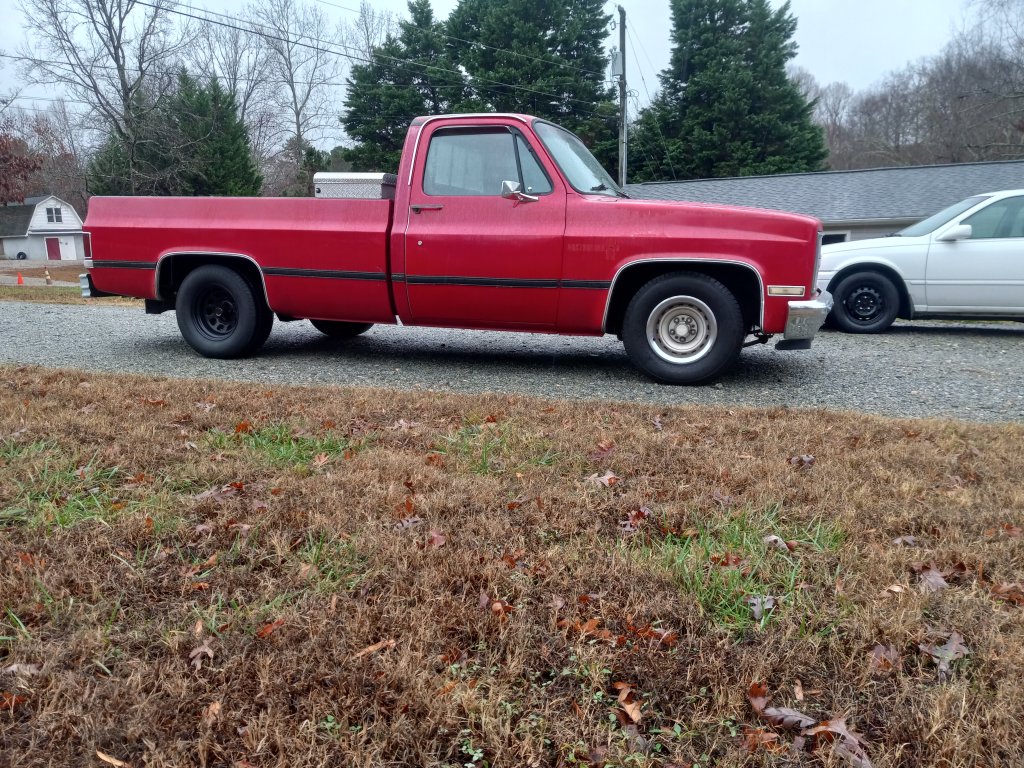

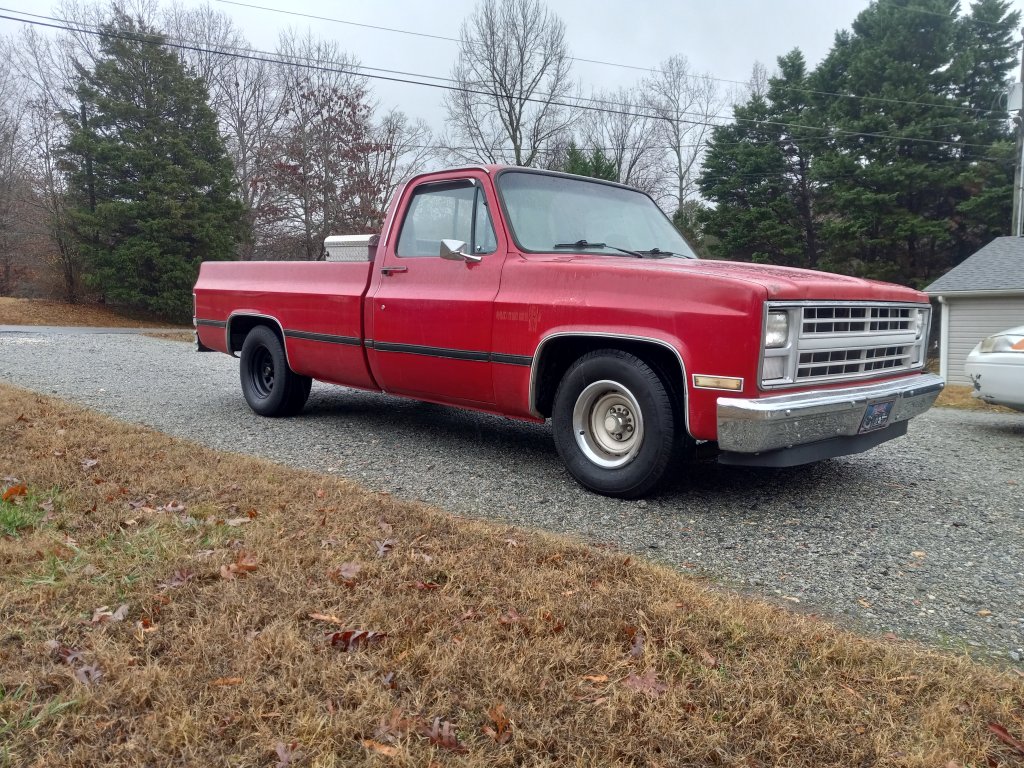

Here she is with 4 inch drop in rear and 3 inch drop spindles in the front. I was hoping the tires would be closer to fender. The back wheels are what I'm putting on the truck, I put 275/60r15 tires on them. The front tires are what were on truck when I got it which are 235/75r15. Not sure what size tire I should use to get closer to fender. Any suggestions?
255/70R15 is gonna give you the right stance IMO

Are they on 10 inch wheels?

Are you wanting your tire closer to the fender in front back or both?

Yes, I'm looking at a 265/75r15. It's a 30 inch tall tire
