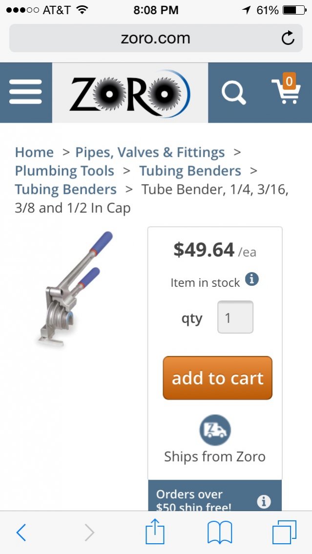

I think this could be a better bender. I have used many of the Imperial brand single size benders and they work really well.
