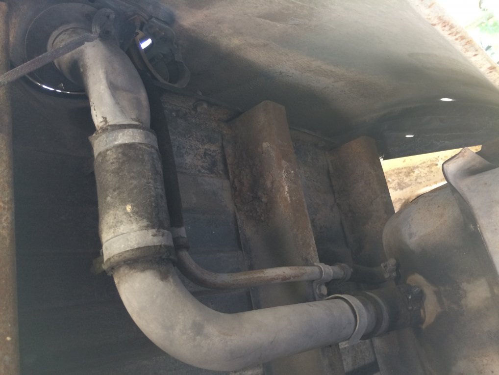

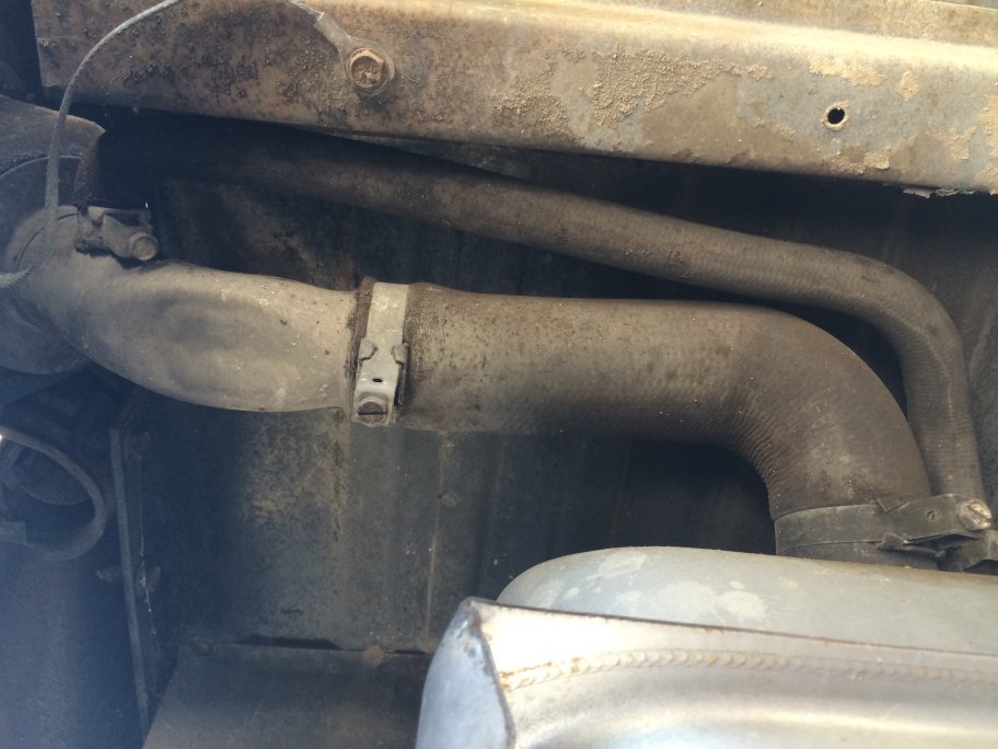

was it ever determined that the 16 and 20 share the same fillers? I am doing the same as you except no tbi
foamypirate
3,302
467
Central TX
Jake (Mr. Wilson)
El Camino, baby!
5.3L/4L60E
Filler tubes are different between 16 and 20 gallon tanks. I'll get some pics, I have one of each on my 84, lol

16 gallon:
attachment.php
20 gallon:
attachment.php
