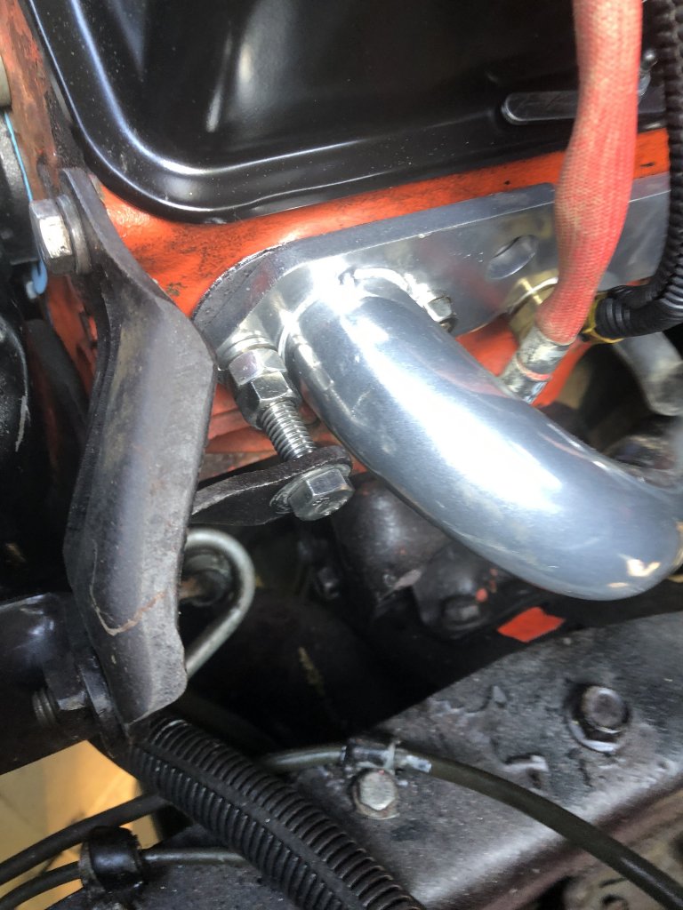

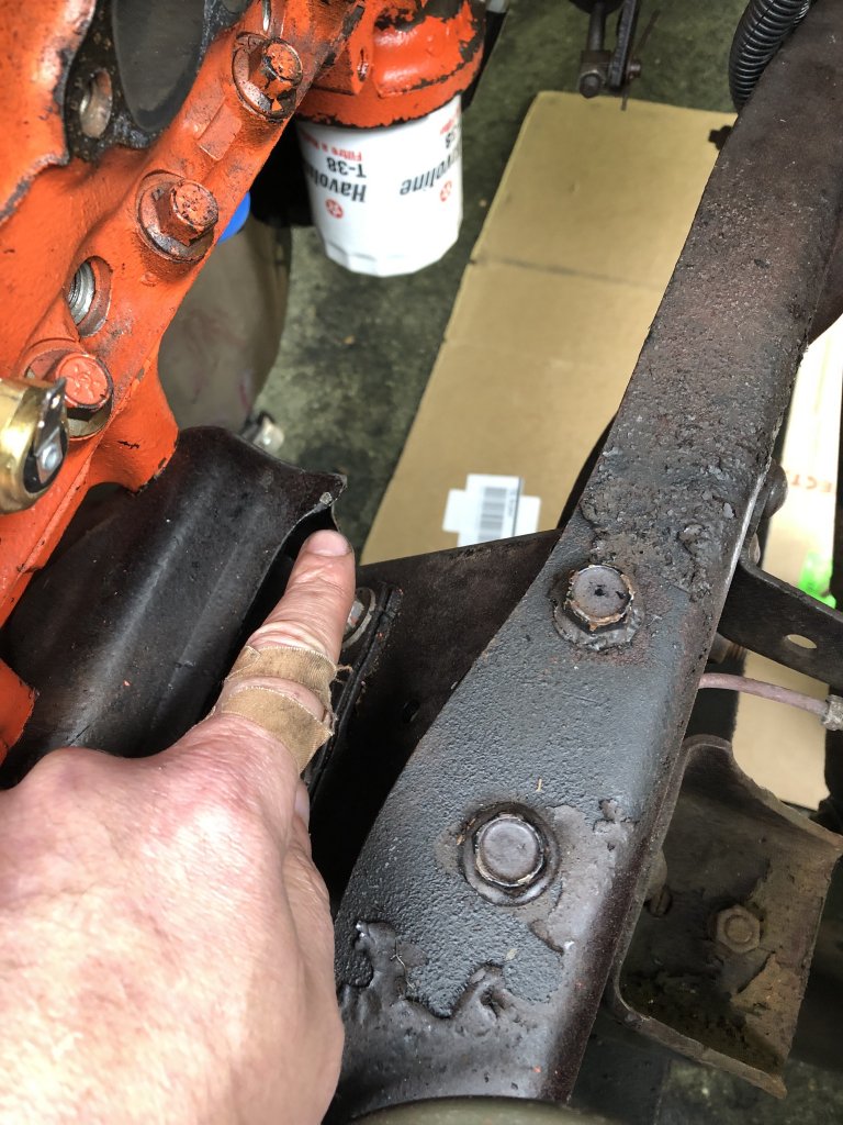

I got headers that fit from Summit:
Hooker Competition Headers 2453-1HKR (available for less $ if non-ceramic coated)
I had to shave the ear off the driver's side motor mount. (see pic)
Passenger side, zero issues.
Summit "check vehicle fit" says they won't fit. They did fit.
I returned these:
Summit Racing™ Metallic-Ceramic Coated SBC Headers for 4WD Chevy/GMC K-Series Trucks, Blazer, Jimmy, V-Series Vans
Part Number: SUM-G9109
Summit website says they will fit. They do not fit, not even close. Hit the frame and motor mount before even worring about the clutch linkage.
I also learned that header bolts that include an internal allen head and the wobble socket are priceless. Mr Gasket I think? Oreillys had them.
My power steering pump was mounted to the old exhaust manifold. I used a stud to fasten the header to the block and extend out for the power steering bracket.
Hope this helps.
