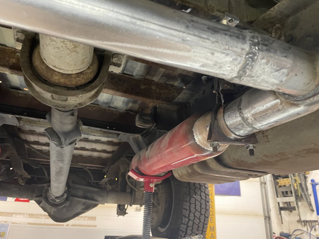

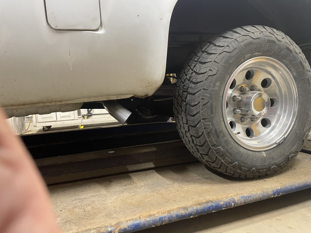

We have ours exiting between the fuel tanks and rear tires. I did long tube headers and built my own dual exhaust with Cherry Bombs, a H-pipe and turn-down tips. No issues yet with the tanks or the tires. Rear rims might get a bit dirty from the exhaust but this isn't a show truck. The rumble still makes this 50-year-old giggle like a highschooler...
